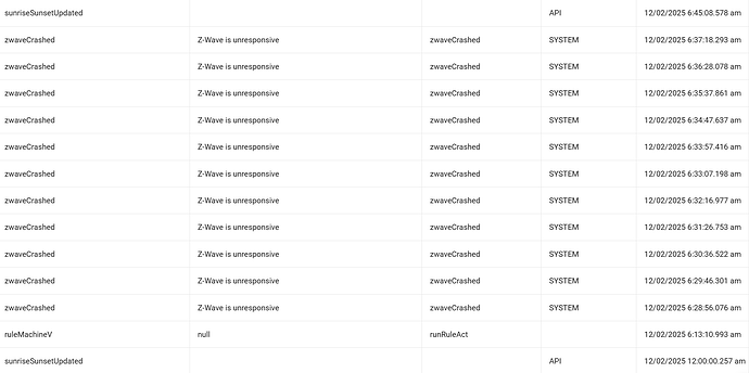

Z-wave crashed re-trigger rule every 50-seconds
I have a rule that notifies me if z-wave crashes. It happened last night on my C8-Pro. Unfortunately, the rule was re-triggered every 50-seconds, so by the time I woke up, I had received a lot of notifications. I've worked around this using private variables and won't get a notification more than once/hour in the future.
Is this a bug, or does it indicate that the system is caught in a loop of attempting to restarting the z-wave radio?

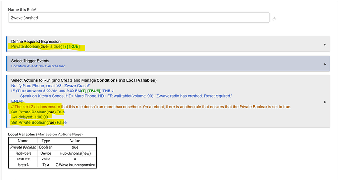

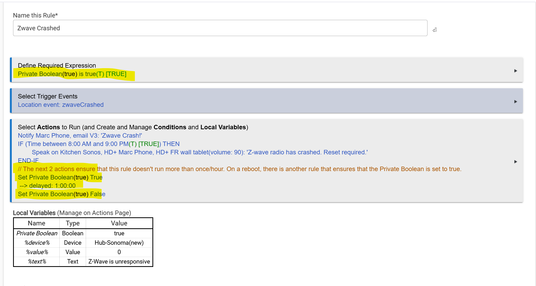

I have already updated the rule to prevent the looping. The screenshot below shows the rule, but with the new statements that prevent looping highlighted in yellow.

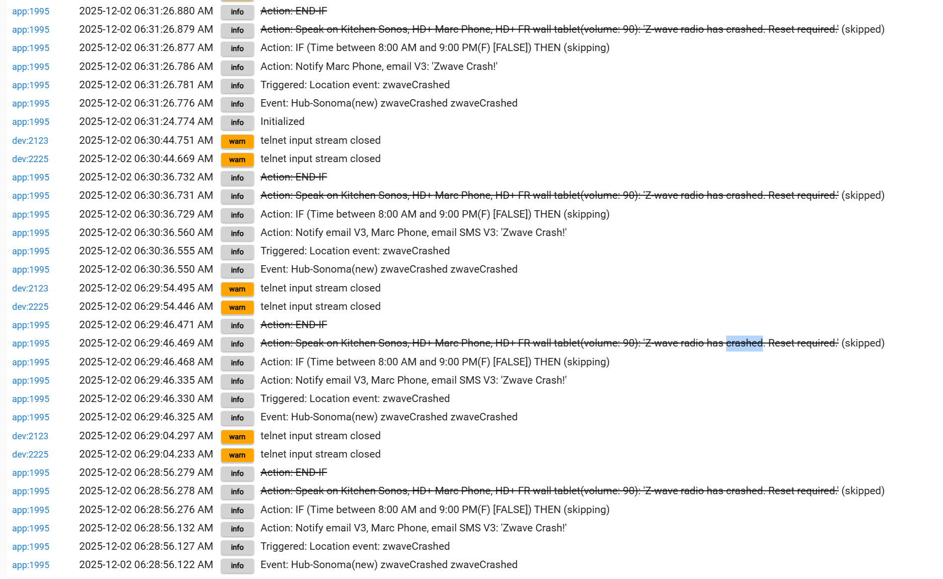

I've also attached an extract from the hub logs that show the crash rule being triggered every 50-seconds.

What is device2123?
The crash seems to occur 42 seconds after Telnet message. Every time.
Device 2225 also at this point.
They are both instances of a device that sends an email message every time a z-wave crash occurs. It's the first action in the rule ("Notify Marc Phone..."). The device driver is called "LGK Sendmail V3". I doubt that is the cause since it does not involve any z-wave activity. It is talking to a local email relay over the LAN.
Marc
Interesting that they arrive 42 seconds BEFORE the event notification for the rule.
I do not think that the email driver telnet socket closing is the cause of the problem. Below I will put the oldest event as the first entry in the bullet list:
  • At 06:28:56AM the "z-wave crashed" event arrives, and the email is sent (2 log entries)
  • At 06:29:04AM the telnet socket stream is closed for the email message that was sent.
  • At 06:29:46AM the next "z-wave crashed" event arrives.
  • From here that pattern repeats.
The patterns I see are:
  • The trigger events ("Z-wave crashed") are all about 50-seconds apart.
  • The timeout of the telnet input stream for talking to the email relay happens about 8-seconds after the email device is invoked.
A bit more important background info:
  • I use that driver to send emails from other rules and it does not result in a z-wave crash.
  • I had issues with z-wave crashes happening about every 7-14 days before I added the rule to notify me about them. At that time there was not use of the email driver, but the crashes kept coming until I shutdown and power cycled the hub.
My conclusion is that the socket timeout is not the cause of the z-wave crash.
