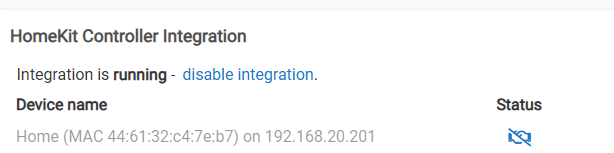

But no devices show up and this is displayed in the status of the pairing:
Any ideas? I have tried the un-pair and re-pair many times waiting as much as 30 minutes between actions.

That symbol says that the device is paired to something, but it isn’t your hub. Try unpairing it again, wait about 5 minutes and then try the pairing again.
Sorry to say but I waited 30 minutes after I unpaired the Ecobee, even power cycled it, shut down anything else that listens for Home Kit (Home Assistant) and the same results. After entering the paring code I get the Blue hands with the slash in it.

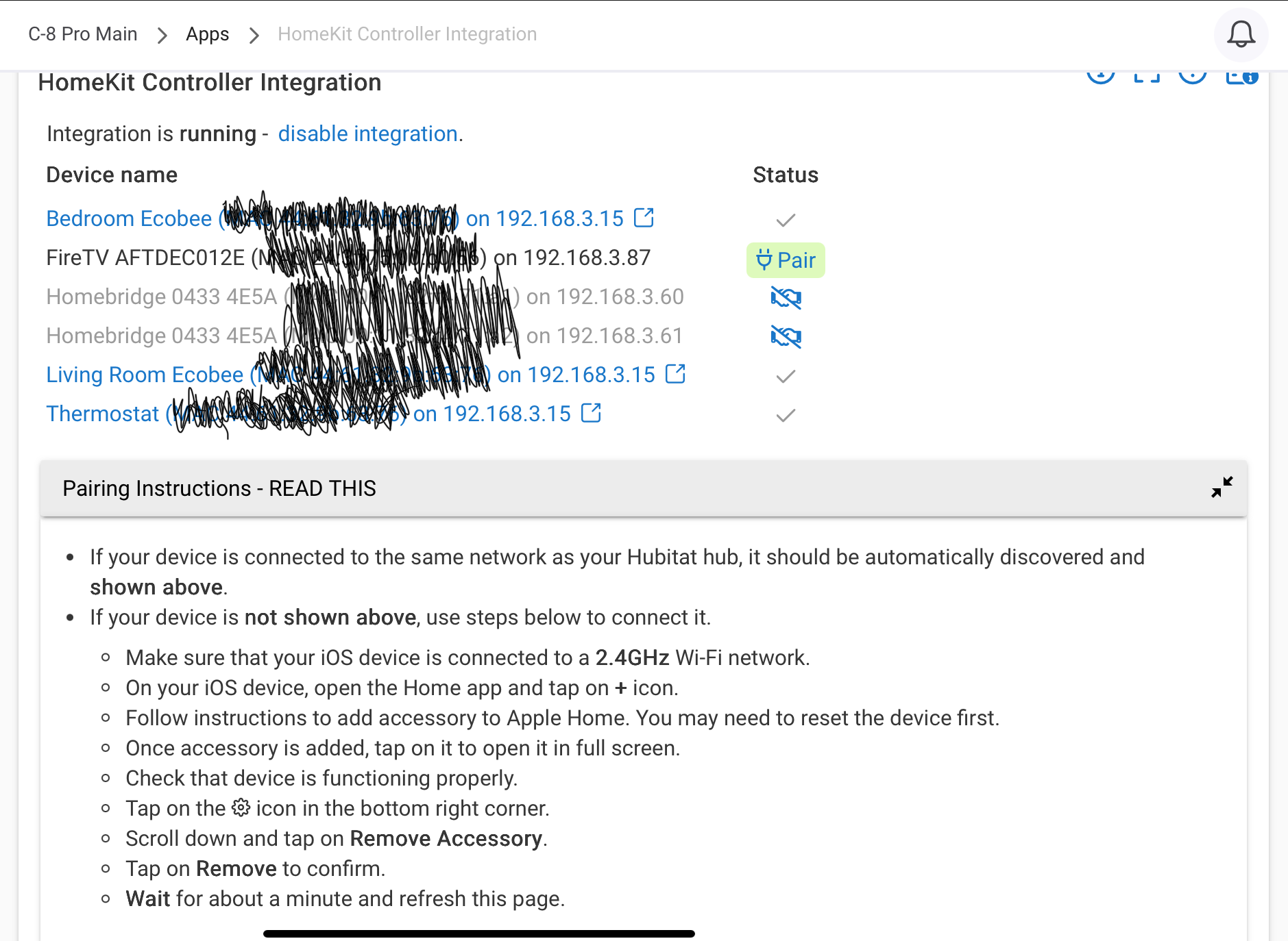

Towards the end of that thread you linked we found it seems to be related to the Add-on sensor.
I ended up resetting my Ecobee several times that day because of a few things. Found that as soon as i added one particular sensor it would stop adding properly. I believe it is the one that came with the thermostat.
When the factory reset is performed you need to add the thermostat back by itself with no add-on sensors linked. Then add them afterwords. They will show up in hubitat once the thermostat sees them after a while. I have one that won't show up in hubitat no matter what i do. I think it is what is creating the issue.
I do believe that @gopher.ny was able to reproduce the issue though and stated a fix may be on its way with 2.4.3 at some point. I haven't seen it yet though.

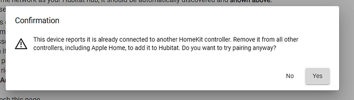

The Hubitat will spin a few seconds more and then state "Pairing has completed successfully" but the icon is the Blue hands icon stating the device is already paired.
Clicking on the blue icon a dialog box comes up with:
If you select "Yes" Hubitat will prompt for pairing code again? Well the Ecobee thinks it paired successfully with the Hubitat, the Hubitat says it's already paired with another device. The only way to get a pairing code again is in the Ecobee settings and removing the HomeKit paring. And do another start paring again on the Ecobee which generates a new code and that code doesn't work when enter into the Hubitat. And the process has to start all over again.
