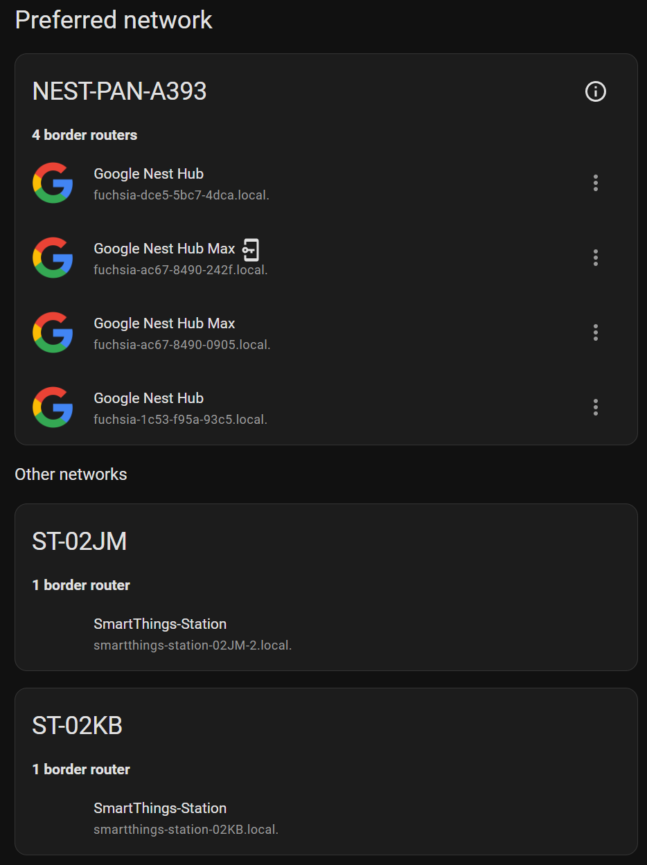

Just came here to say that all my Wifi Matter devices work flawlessly... Thread? Not so much.
All of my Thread devices are Nanoleaf so I guess I pull back my blanket statement... a bit. I have three separate Thread networks that I can't get to merge.
Join the club on thread.... I have 3 thread networks, can't merge them. Tried scrapping them and re-doing them in the recommended (by vendor, lol) order... Ended up with... 3 separate Thread networks in the end again. :man_shrugging:

As for Thread, I'm definitely not giving up on it. I just don't like seeing this knowing that they are meant to be merged. Right now, the ST networks are just taking up space in my 2.4 Ghz band.

Even then though I never could get Alexa and Google home on the same thread network. Tried four or five times, a different way and different sequence each time.
I obviously did not expect my Apple home (set up via an iPad I have) to play nice with the Android side. That is actually my fourth thread network.
