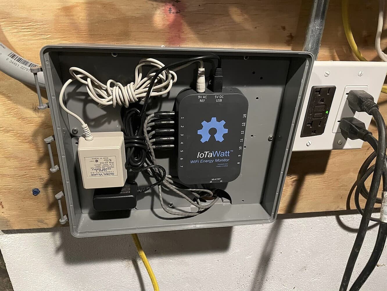

I have a pair of iotawatts that I use to monitor circuits in my house and am very happy with them. I like the fact that they are all local and don’t rely on third party infrastructure in the cloud. They’re pretty flexible in that you can do things like integrating over time to give energy as well as power readings.
I primarily use these for monitoring so I chose to bring them into home assistant where the trending graphs are far simpler to produce. As a result I don’t have any experience with the Hubitat integration. I do have a couple of instances where I take some action based on power consumption, but I just bring those values across using HADB integration.

I have a pair of IoTaWatt devices, one for my main panel and the other for my sub panel. They work great and have been very robust and reliable. I have them sending all of their data to a local instance of InfluxDB and Grafana. This provides a great combination of tools for monitoring and analysis.
I wrote the Hubitat integration for the IoTaWatt which I use for things like washer and dryer cycle completion notifications.
