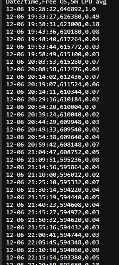

As you can see from the attached screen grab of the “freeOSMemoryHistory”, I am experiencing an almost predicably linear increase in memory utilization. Even when memory availability is not critically low, I am still having the issues.

That decline on your memory is perfectly normal with the JVM OS that is running. It just keeps caching things which slowly appears to eat up memory. The memory is used by cache but can be freed back up by the OS as needed.
The issue that came up in 2.3.6 you would see a hub go from a fresh reboot to below 100mb free in 2-3 days, and eventually the hub UI would not be reachable anymore forcing a hard reboot.
The fix for that is simple, download a backup and then restore it. This cleans up the database in the process, which for some reason fixes the issue. I am not privy to why this is the case. Most people do not see it return again once fixed.
