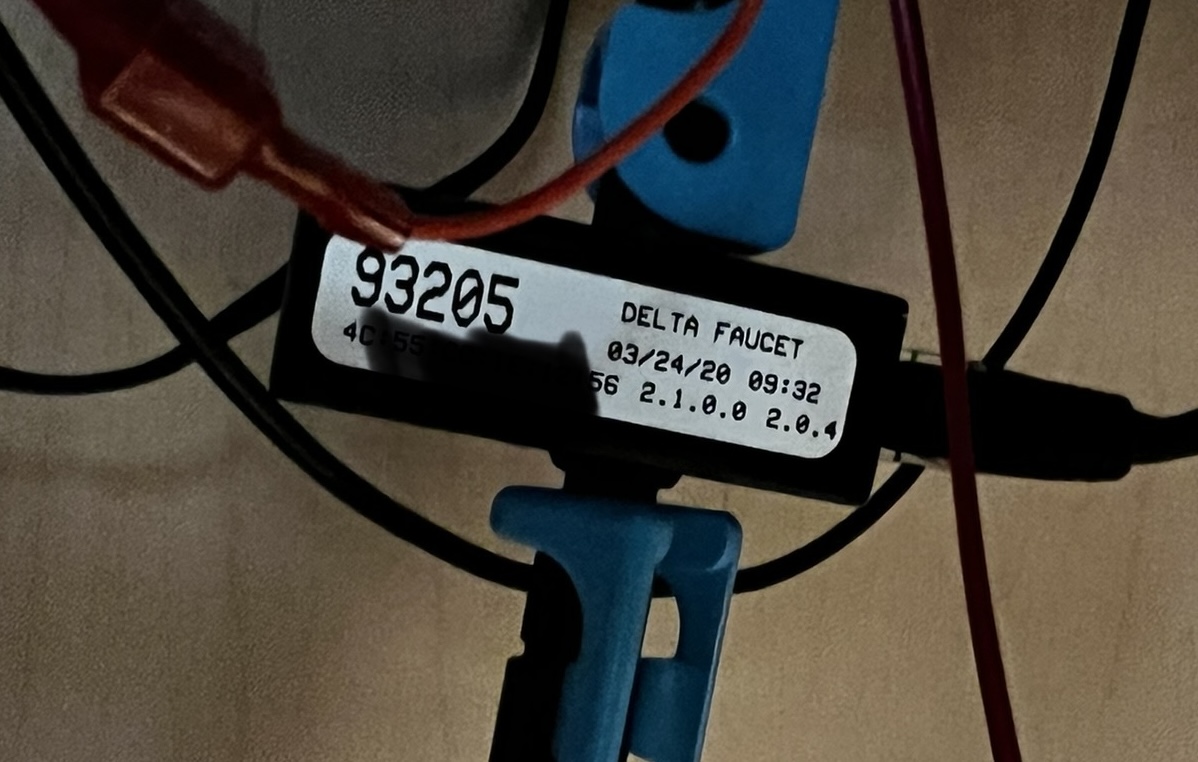

[Edit] Looks like I have a version 2. I’ve had it for several years, but I guess I got one of the first v2 ?
Wrong, I have version 1

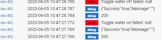

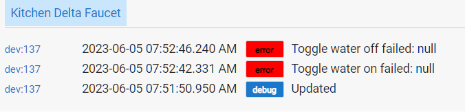

OK, I tried this updated driver and it works but produces an error for each sent command:
This is not a big deal but better to be suppressed.

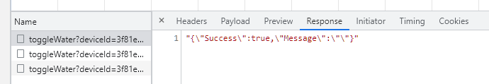

OK, I sent On/Off commands from the web GUI.
Here is a response (if I looked in a right place):
"{\"Success\":true,\"Message\":\"\"}"
That's the data payload. You actually want the HTTP status code if you can find it.
Alternatively, you could add this to the Hubitat driver code to the line immediately before the status checking code:
log.debug response.status
Here's what I tried:
log.debug response.data
log.debug response.error
log.debug response[1]
I wonder if the JsonSlurper().parseText() might not be working? The response.status does indicate success it seems...
So:
response.status = 200
log.debug response.data = {"Success":true,"Message":""}
log.debug response.error = nothing?
log.debug response[1] = nothing?
This is an exact response I got from GUI:
But each " was \"
This seems correct in the debug log, so I'll bet there's a type mismatch that is causing the check to fail.
Try this:
if(response?.status?.toInteger() == 200)

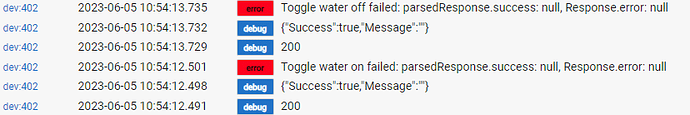

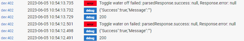

Error with this code:
From what I gather, the following if condition is not successful:
if (parsedResponse.success)
And the parsedResponse.error is null
Updating to:
else {
                log.error "Toggle water ${toggle} failed: parsedResponse.success: ${parsedResponse.success}, Response.error: ${parsedResponse.error}"
I get:
Ah, I didn't look low enough. That parseResponse.success is probably the issue. Just try this stripped down approach:

I cannot see what is on the label but my toy was ordered on January 20, 2022
I guess, the part number is EP100855 (from Amazon order).
