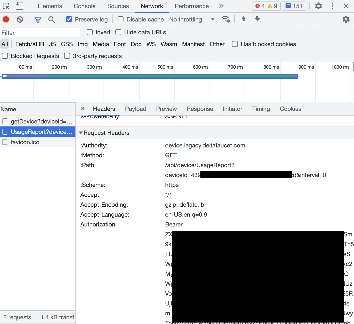

Method 2:
  1. Using Google Chrome, navigate to https://device.legacy.deltafaucet.com/
  2. Click Login with Amazon
  3. From the Chrome View menu at the top of the screen, select Developer > JavaScript Console
  4. At the top of the console window, click on the Network tab.
  5. On the Delta faucet page, click on the blue button labelled Water Usage - This Week
  6. Expand the left side of the inspector window.
  7. On the Name column, click on the result that starts with UsageReport?deviceId=
  8. On the Headers column, under Request Headers you will find the required deviceId (also shown in the URL address bar after usage/) and the full Authorization token needed.
NOTE: Copy the entire authorization token after the word Bearer. It ends with and must include ==

How did you get the token? I tried the method on GitHub but I don't find "window.localStorage.auth_token". I'm only able to find my device ID in the URL.
Also tried the instructions from the HomeBridge plugin, but they don't make sense to me and don't yield a result I recognize as the secret I need for my faucet.
Any help would be much appreciated. I've wanted to have something like this working for several years now.
Please check the very first post in this thread.
You have to click on "show original" in order to see the entire document.
The instruction is on top under README section.

Yes. But actual TOKEN is about 500 characters long. You have to hit "enter" in the console
window and it will show up entirely. You can use a "network" window. It has a lot more info.
That is how I figured out the original script was not right.
Thanks! That's what I was missing. Still getting the Error 500 when I try to "Save Preferences" - not sure why yet... Will likely not be able to go much further on this before I need to go walk the dog...
When I don't make the token mandatory and leave the field blank, it works, so likely an issue with the variable type...?
I see my mistake. Was trying to 'find' in the console instead of typing that in the console. I have my token, but I seem to be too dense to work from the limited instructions for both HA and the HomeBridge plugin.
