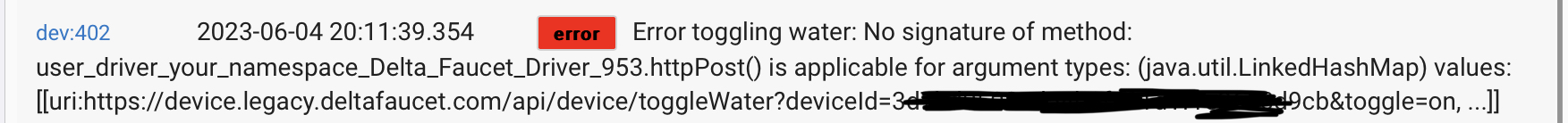

Unfortunately…
I wonder if I implemented the change correctly?
Considering I know just enough to read Groovy and barely understand it, I wouldn't be surprised if the error was a very simple one...

You missed the lines below httpPost in my message, and that closure is what is missing which leads to the error you saw.
Oh, I didn’t realize I needed to add that as well - oups!
Added and you were right, it fixed that error!

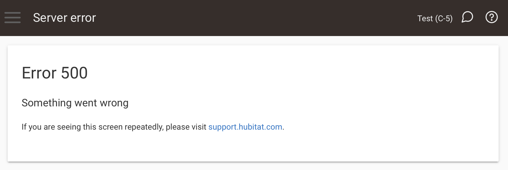

Error:
I’ve added the WIP code to GitHub:
Try taking these out. They look like app data that bled over thanks to ChatGPT.
required: false, displayDuringSetup: true)
That's just a guess. Otherwise, I don't have any other theories. How many characters are in the token string?
Unfortunately, the error remains even with that removed.

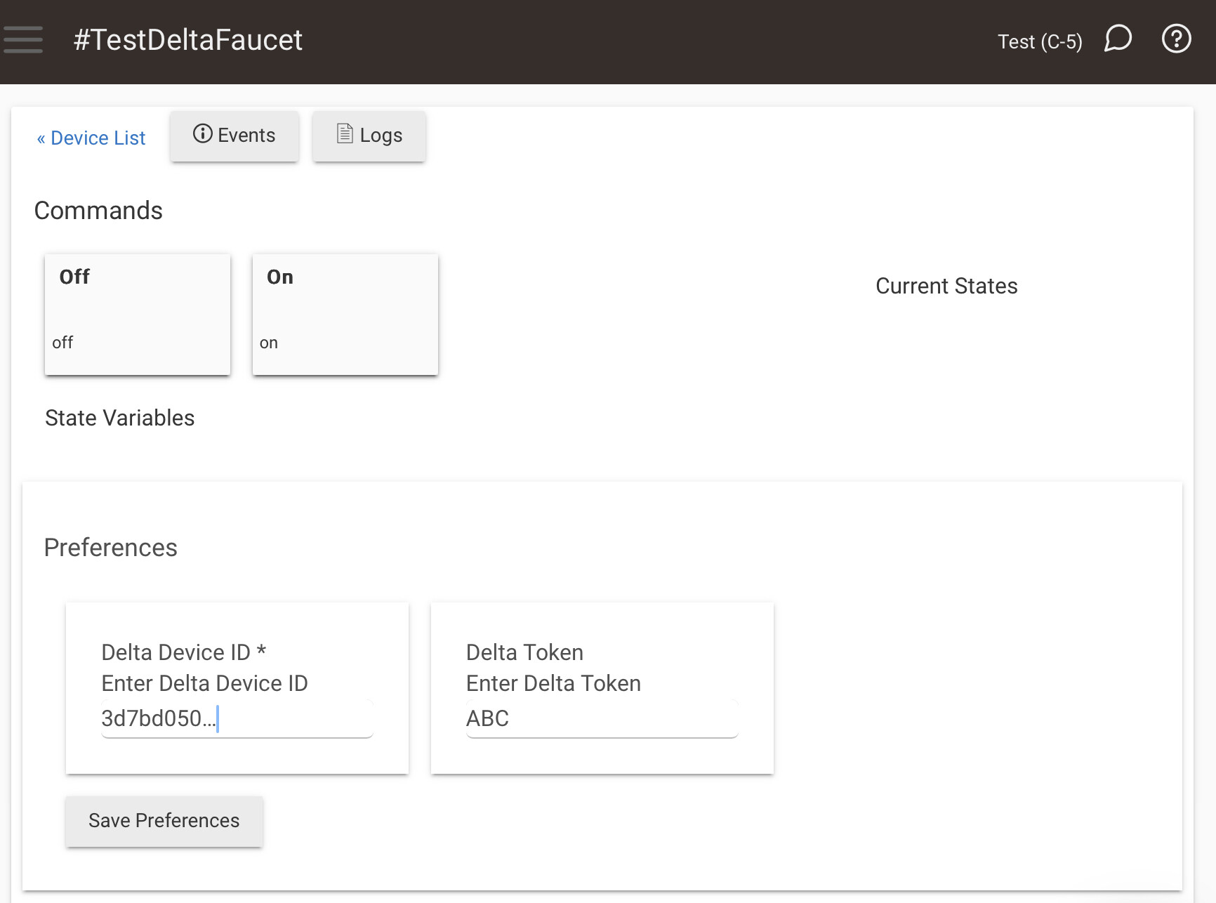

What if you try to save just a short string; does it still fail?
Good question! Yes - I tried: “ABC” and it worked. So that confirms an issue with the content… I assume size…

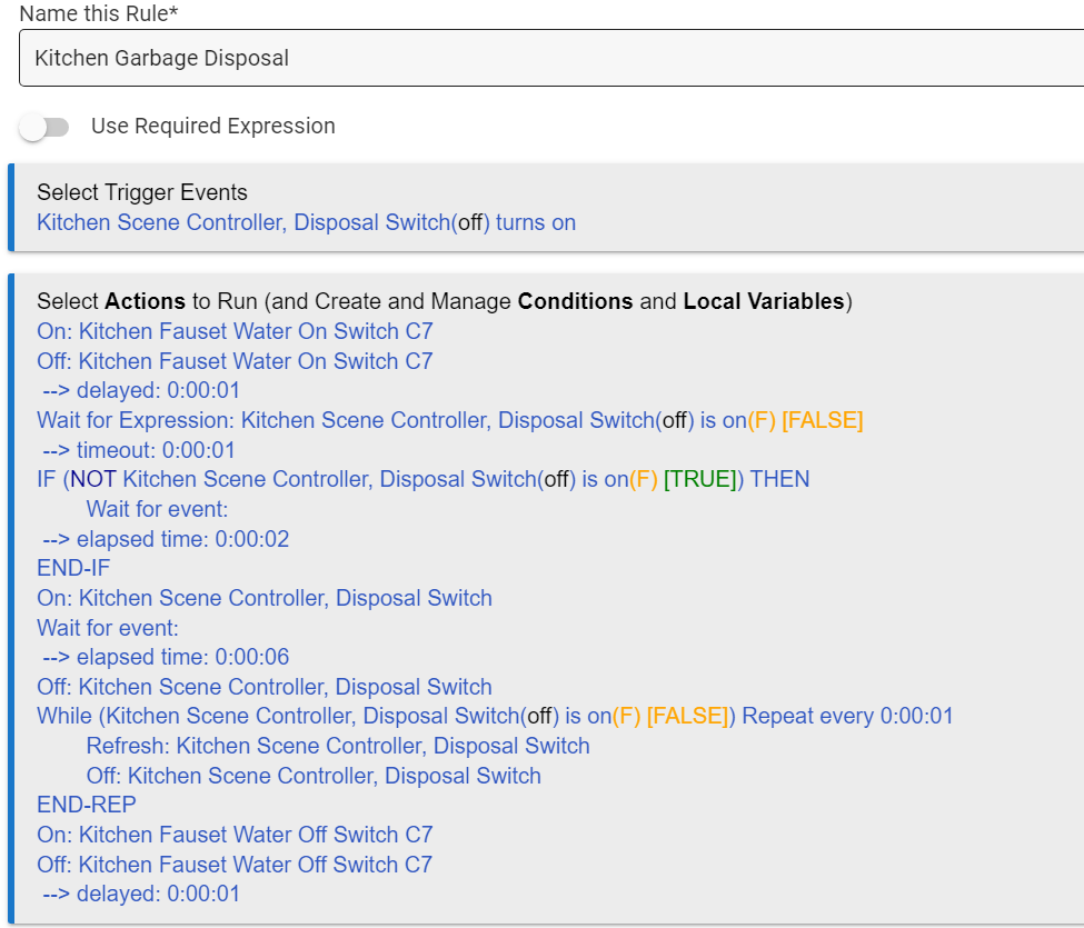

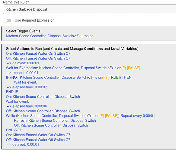

just in case here is my RM rule for controlling Garbage Disposal:
HADB is installed on C7 and hub meshed to C8.
Actual RM rule is on C8
