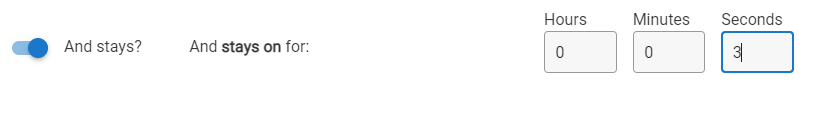

Just found this option in the Rule Machine documentation, which I think solves my intrigue:
The And stays? option, also called a "sticky trigger," is option available for many types of trigger events. (If this option does not appear, that particular kind of trigger event does not support this option, generally events that do not relate to state changes.) For example, a trigger of Front door opens and stays that way for 0:05:00 will trigger only if the front door opens and remains in an opened state for 5 minutes. If the door is closed before that time, the rule will not trigger.
Thank you!

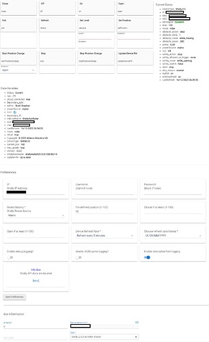

Wrong driver. You need to set it to the "Shelly 2/2.5 as Roller Shutter" Driver.
Shelly Drivers
Then your device_page should look like this:
Sorry for the delay. Thank you very much for your help. I have installed the drivers you linked and it is working now, but I need to make a rule triggered by the event that takes place when I have pressed one of the push buttons wired to one of the shellys input, by I cant see any variable that shows that shellys input 1 is on or off. Same issue for input 2. Any way to access these variables?

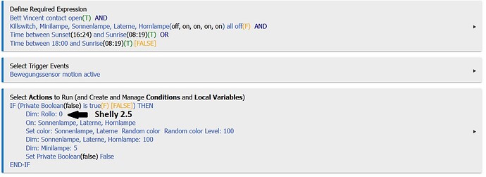

Only indirectly. Input 1 and 2 are used in this case to either trigger an up or down movement. What you can do is write a rule based on the position of your roller shutter in percent. Hubitat is defining your roller shutter as a bulb (don't ask me why), so you can easily write rules based on that. Here is an example of one of my rules:
Just a note for my lamps, before there is any confusion, because of seemingly unnecessary additional steps (turn on, set dim etc.). This is because of some older Ikea-Bulbs which tend to have some issues with a few steps at once. Your rule would be much shorter. :slight_smile:

I have 7 roller shutters in one flat. Each one controlled by a shelly 2.5. Each shelly has 2 physical push buttons wired to its inputs, one to open the roller and the other to close it. I want to get this: If in my room I press the physical push button(wired to input 1) during i,e 3 seconds, not only the roller of my room will open, but the other 6 too. If the state of the variable input 1 is available somehow, when I create a rule´s trigger on the rule machine there is an option called stays on( called sticky trigger on the manual), where I can choose the time that the input has to remain on to trigger the actions, which would be 6 actions to open the 6 rollers.
