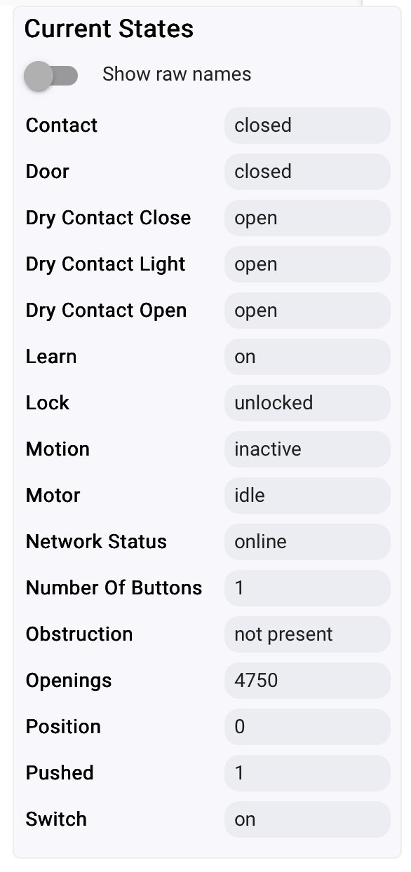

Using RATGDO on a relatively recent Chamberlain/Lift Master garage door opener allows bringing in the door open safety sensor (obstruction sensor) to Hubitat, as well as many other components (motion sensor, light, etc.):

Integrating the beam sensor with HE enables me to:
FWIW the beam sensor or Infinity Shield in my case is directly connected to the garage door opener for safety reasons. RATGDO exposes the beam sensor status to HE.

I have a rule that plays a warning siren when the garage door is going to close. Currently, I have to wait until the siren ends and break the safety sensor beam with my foot. I’d like the siren (rule) to stop as soon I break the sensor beam.

I purchased a RATGDO. Which driver are you all using?
Please search the community as there are many threads on it. I am using this driver with mine.
Ya, I did. There doesn’t appear to be a clear winner so I asked. Unfortunately, I was tired and didn’t ask the question I intended to, so I have edited my query above.
I use this one:
https://raw.githubusercontent.com/bradsjm/hubitat-drivers/main/ESPHome/ESPHome-ratGDO.groovy
(Likely the same or extremely similar.)
The one I mentioned is based on that driver but @ady624 made some additional improvements to it.
As you will see in the thread I mentioned, I edited it a bit further disabling the "position" attribute from mine. That is the value for percent the garage door is open and that is a very chatty update if your garage is opened and closed a lot. It is not something I really care about so again I just disabled that code in mine to reduce hub load processing the events.
@Busthead one thing to mention, I had heard that some sort of encryption was added to the RatGDOs at some point (after I purchased mine) and it might not work with this driver. Some are having to pair it with Home Assistant to remove it before it will work directly with HE. Again I don't have experience with that and I might be misunderstanding what I read here but something to be aware of. Curious if this driver works for you.
