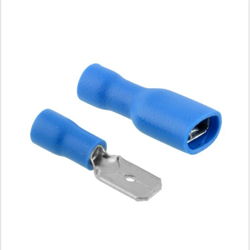

A crazy idea popped into my head last night. Instead of trying to wrestle a bunch of wire nuts into the canopy, I think that I am going to use crimp-on insulated blade connectors on the stranded wires between the fan and controller:
They meet the temperature and current ratings, and apparently are acceptable under code inside an appliance or even in a switch/outlet box with stranded wire. It will make everything so much cleaner to only have the three wire nuts on the solid romex to wrestle back into the box, and pay dividends later if I ever need to take the fan down for maintenance or to paint the ceiling when I only have to pop the three blade connectors and not touch the wire nuts.....

I switched mine to the snap-closed lever variety of connector. A bit bulky but it was much easier to deal with while I had the fan hanging there, especially since in my case that electrical box is where there are multiple other wires connecting... so my neutral has 5 connections. A bit much for a normal wire nut.
