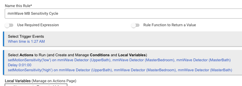

Someone suggested changing the sensitivity then changing it back will keep the Linptech running. I have 3 of them and I'm using that technique and it seems useful.
Since you have a Test Environment setup, perhaps you can give it a try.
FWIW this is a YMMV solution, at least in my case it didn't keep one of my Linptech's I tested w/this approach from going offline. But if it works it's dead simple to set up and doesn't require any additional HW, which is great.
Have you tried being more 'aggressive' ?? Longer time between, multiple settings (low, mid, high)?
I have seen this option (@danabw mentioned this as well) and tested it with 3 at that time Linptech sensors. Unfortunately, this "fix" did not work. All my 3 Linptechs required a power cycling in order to bring them back online. Frankly, I don't like these types of solutions (i.e. power cycling, periodic reboots and even watchdog timers, my EE brain simply cannot accept them).
Let me see how Switchbot BT mmWave sensors will work overtime. So far they are OK, except too slow for the turning lights ON. They have built-in PIR but somewhat this PIR is not helpful (at least visually). That is why my "fix" to use a standalone PIR just for improving initial response time.
How do you use it and on what hub model? I've been testing a few of these on my production C-8 Pro hub and they are as fast as any Zigbee PIR sensors.
Funny you should ask...just re-initiated my rule to change sensitivities...was weekly, moving it to daily like yours. One sensor set to low and then back to high, another to low and then back to medium high, a third set to low and then to medium. I'll watch and learn...since I don't remember which of my sensors used to fall off I'm going to test the first three and if they all stay connected for a month or more I'll then try the setting changes w/the remaining four Linptechs I have. :slight_smile:
I'll report results in the Linptech topic since @vitaliy_kh is not interested in this approach.
