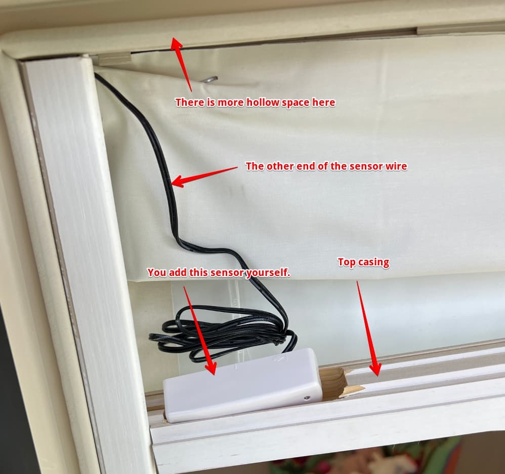

The sensors are a rare earth magnet and a contact sensors that ends in bare wire within a hollow area (top casing in windows, under the deadbolt in doors) that is big enough to hold a sensor of your choice.
In the windows, the magnet is embedded in the sash, while the sensor sits on a lever inside the side of the window casing. When the window is flipped to the "locked" position, the lever inside slides up, placing the sensor within range of the magnet, closing the sensor. When you unlock it, it slides down, out of range, unlocking it. I'm sure the doors work similarly, but I haven't opened one of them up yet.
That's what you get when you buy a Marvin product. Connecting the window to your system requires another sensor, one that you can plug the bare wires into. While I imagine there are sensors for most of the major formats, I opt for z-wave and am using these sensors, which you can open up and feed the wires into.
Hooking up the sensor is simple. Pop open the case, feed wires through the base, put them into the contacts on the inside.
Once you have the additional sensor hooked up (and the tab that blocks the battery removed), you can bunch up the wire, slide the sensor and wire into the hollow portion of the window casing, and close it up. If you're smart, set up the sensor before you do this step. Opening the window casing back up isn't terrible, but it's a bit of a pain. The doors are easier to work with, as they have a panel under the deadbolt that opens with screws.

Nice write-up thanks. So the battery powered sensor you add is inside the window casing? Not immediately accessible when you have to change the battery right?
@marktheknife Correct. For the doors it's easy — you just unscrew a panel. On the windows you have to gently rock the top of the casing while pulling it down until it opens enough to access the sensor. I've done it a good 30 times now and it's simple enough to do, there's just a lot of friction which makes it feel tricky.
Our sensors have been active for about a year now and they're still in the 95-100% battery range, so I imagine replacing them is going to be an infrequent ordeal. WIth that said, we don't open and close the windows often, so I'm not sure how the frequency impacts the battery usage.

Are you able to take a video sometime of accessing the sensor in the window? I’m not fully understanding how that’s done.
@soccerjoshj07 I'm not able to do that this week, and while it's not super hard, it's non-trivial enough that I don't really feel like doing it :grimacing:.
The short explanation is that there's a casing around the inside of the window. When you open the window, it's the part that overlaps so that air doesn't get through. It's made of four edges (top, sides, bottom) and you can slide a putty knife or other thin tool between the top of the window and the casing to slide it down. It's a tight fit but with some wiggling it'll slide down far enough that you can access the compartment where the sensor sits.
From my image from before, this photo is taken from above the window. The "There is more hollow space here" label points to the place where the top casing sits flush when it's slid into place.
@cameronmcefee Gotcha! I think I was just missing the orientation, you are from the top of the window and pulling the casing down. Makes sense now.
