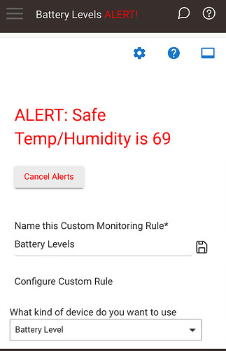

The device picture above is a zooz ZSE44 temp/humidty sensor. I just changed the battery last week. So while high, I also think the value is a reporting lower than it should be. Yes it is in a safe, but the same sensor same battery brand previously was in service over a year before it finally reported low last week. The driver on that driver is
Battery values are ranging from 52 to 69% now down to 61% since I posted

Just switched to a bigger screen, and found more. Front Door open/ Close Sensor, Ring Alarm Contact Sensor Gen 2 reporting low at 100. No anomolies in the log. straight 100. So why would it suddenly start alerting low? This device has been in service for about a month.
Here is how I have it set up, Does anyone see anything wrong with it? I have had this set for a while, (at least 3 years) and have not touched it since I set it up. This just recently started happening.
