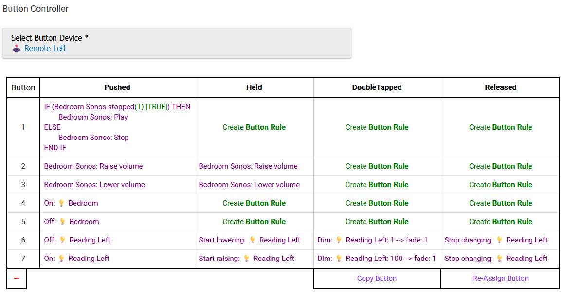

Hi all, I'm trying to get the Symfonisk remote Gen2 to control my Sonos setup and @dandanache driver for E2123 only allows for zigbee devices to be picked from the drop down list. I tested the remote and it controls zigbee device picked from that list. Since Sonos device is a virtual one using "Sonos player" driver I can't pick it as it's not in the list. Any help is appreciated!
You need an app to control your Sonos setup using the Gen2 remote. Zigbee bindings (the drop down list you are talking about only works between two Zigbee devices).
I use the built-in Button Controller app for this, but you can also use Basic Rules, Rule Machine, etc. My setup with Button Controller looks like this:
In the setup above, I only use buttons 1, 2 and 3 to control Sonos, rest is for controlling lights, but you can do whatever you need :slight_smile:
Hope this helps, cheers.
