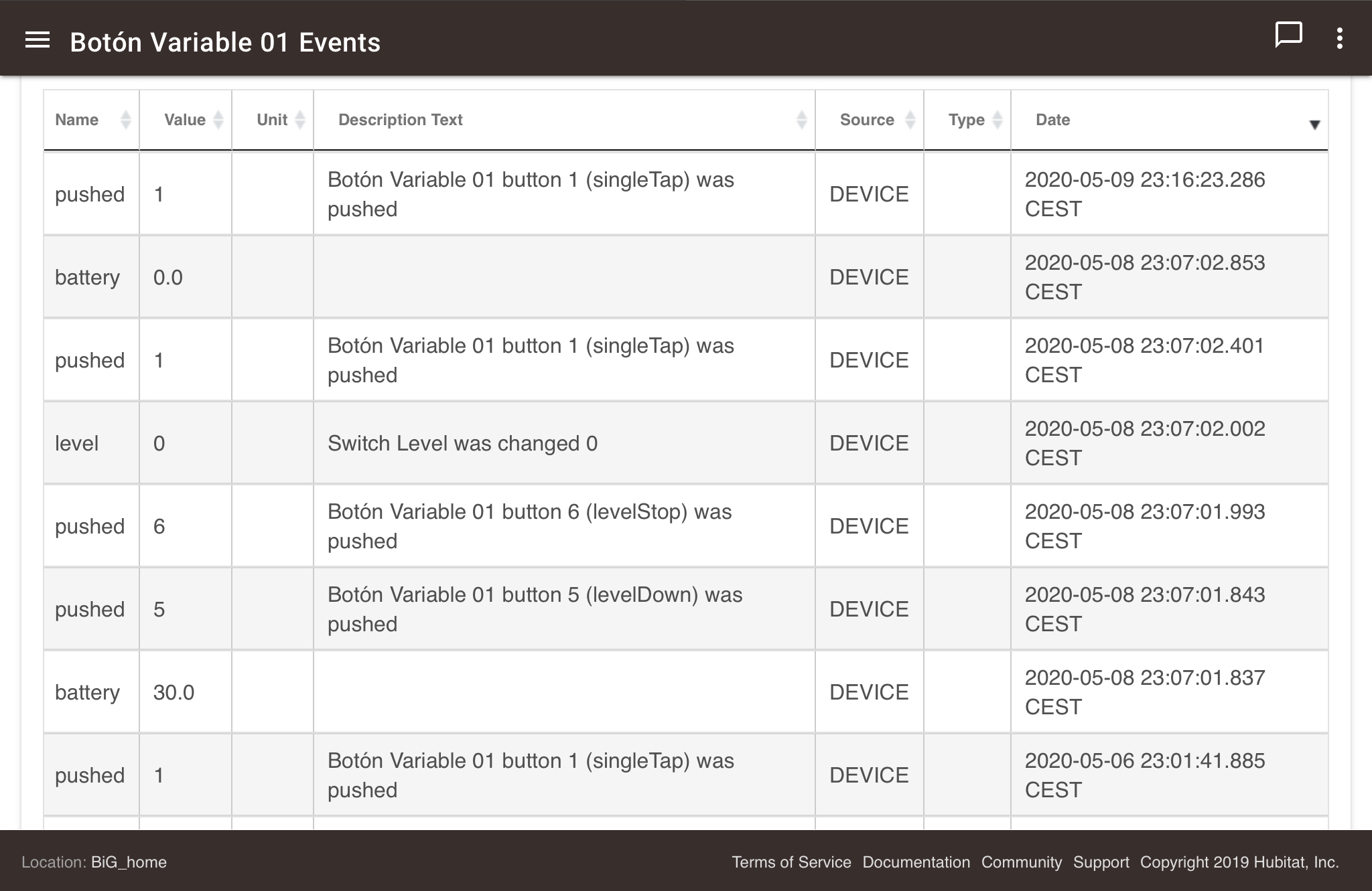

Is the battery level correctly reported?
In frequency and value?

This time it took about 6 days from when I paired it for the battery to go flat. (The device stopped working and I checked battery with a multimeter)
I really like the form factor of this button but think I'll just stick to the Samsung ones for now.
Anyone make any progress with this? would love to see it working like an "analog dimmer" style control out of the box.
Tested one, got it working, but got the battery drain issue. Is that connected to the driver or a faulty unit?
I am now using three of them. All three report battery wrongly. One has been at zero battery for months now.
I believe it is a driver issue. Nevertheless, IMHO, they work fine and their use as dimmer with this driver is great.
Thanks for that, the IKEA leaflet shows press and hold for greater than 10 seconds, rather than 4 rapid presses, but your method worked, theirs didn't.
Has anybody found a fix for the battery reporting issue?
I have just changed the battery in one of them and cleanly fresh reports 50%.
They work well, nevertheless.

Have you tackled the battery issue for this device?
Nope, as it says on the driver page I couldn’t make any sense of it. There’s a fudge in place to make the reporting a little more realistic, but the battery level changes depending on which button you’ve just activated. Pressing almost always results in a report of 11% for some reason.
Thanks!
And your experience of consumption with your driver?
I haven’t been able to understand what determines their consumption. I have been substituting them for other buttons. Strange that I have one with more than eight months of fully reliable behavior.
Well, it's only a few days old at this point so I can't really say, especially as the battery data appears to be nonsense. Right now it's been connected to the network and reporting in at least hourly for 4 days and the battery says 87%. But then it's said 11%, 44%, 150%... In fact, if you press the button and then force a refresh (which asks for the battery data) it often comes back and says 11%... but not tonight. Seems we're stuck on 87%.
