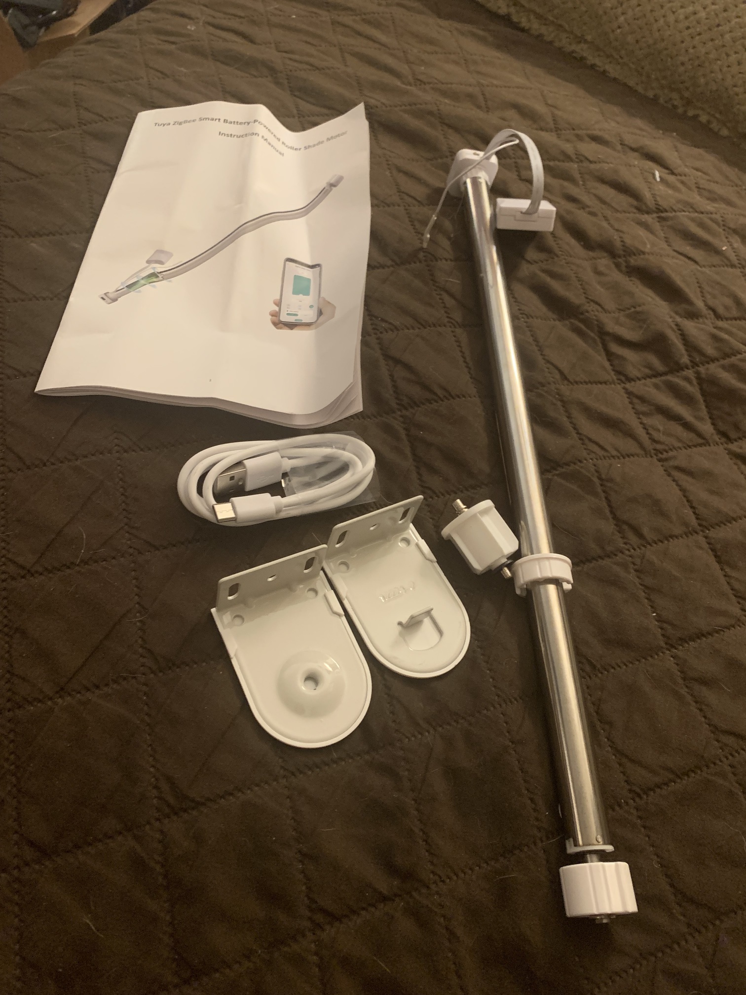

The Tuya Zigbee motor from AliExpress arrived. It comes with both a 25mm and 28mm end. Of course the larger adapter falls right into the tube. And of course I can’t find the end of the IKEA motor that fits in the tube to see if I can modify it. Found everything else though.
S
Before I go any further, I am going to try and pair this with HE.
In the photo, notice how small the battery is. Possibly a way to add a couple 18650s .

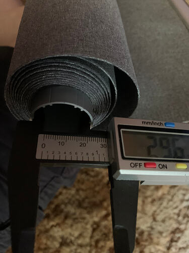

Another issue is the tube diameter is 29.6 cm and the largest adapter in the box is 28mm. I can buy this for a 38mm tube so reducing the size of the adapter and a little gorilla glue will keep it together.

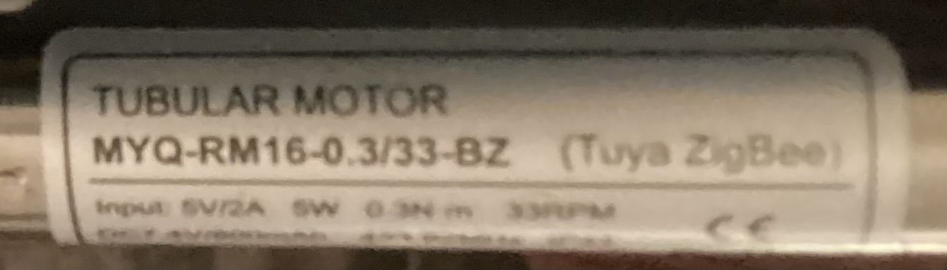

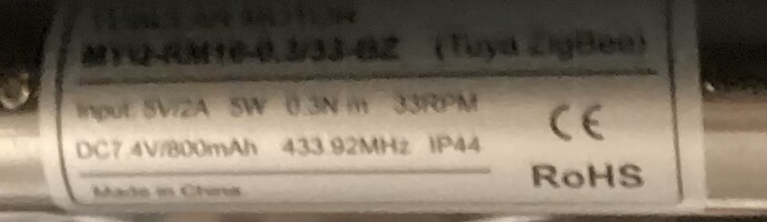

The motor is made by my but neither the Tuya or the Myq websites have information about this.
The first 3 in the part number is the torque and the 33 means the shade rotates at 33 rpm.
