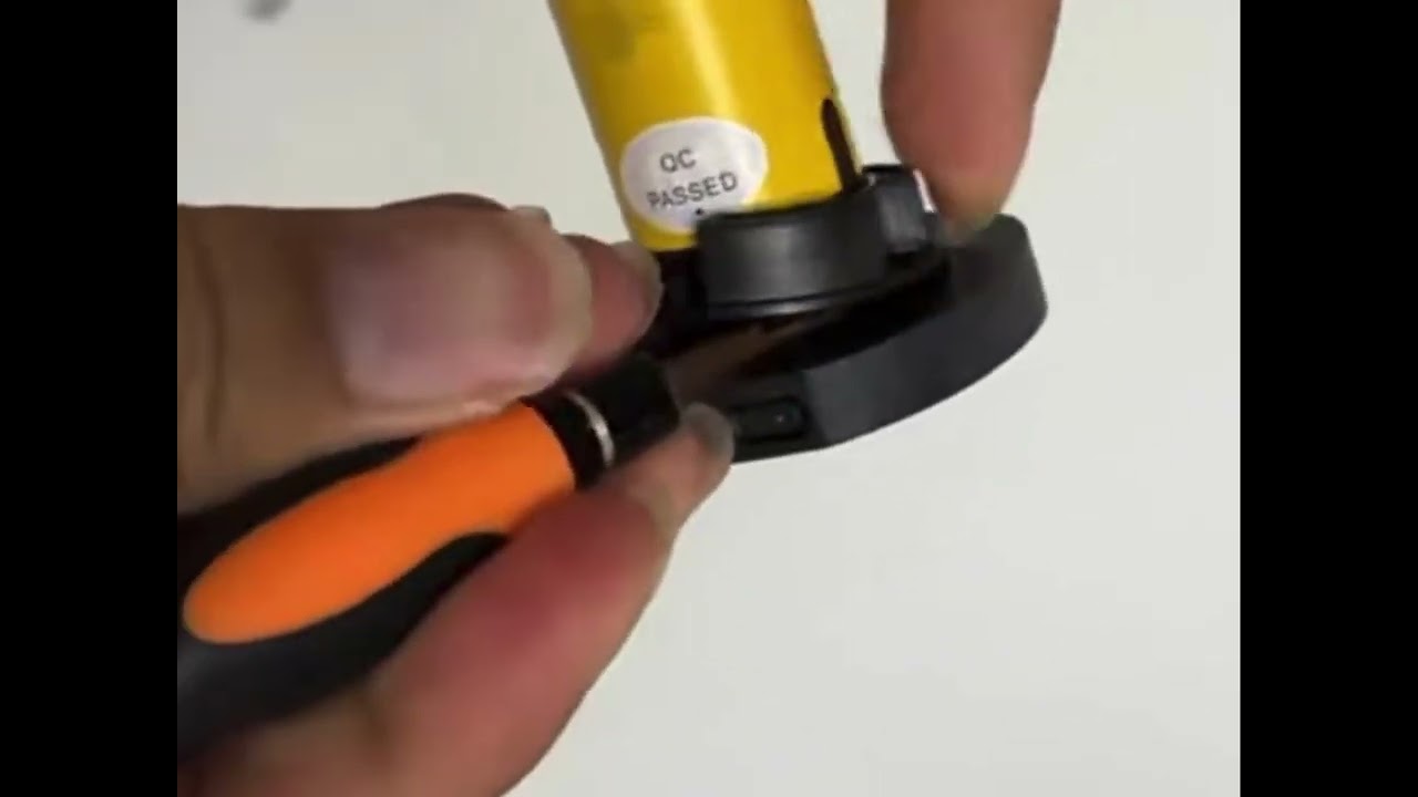

Rollerhouse sent me a video showing how to replace the piece at the motor end. Looks like it has to be broken to remove it.
Updates as they happen.
Here https://youtu.be/vXaiBOm-YtU?si=y0q0A7rHLLYTJ4Lp is the video showing how to replace the plastic pieces that determine the size tube.

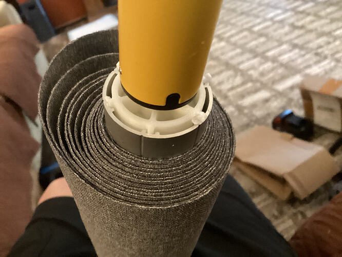

Here is a zoomed view of the removal of the other plastic pieces that determine.

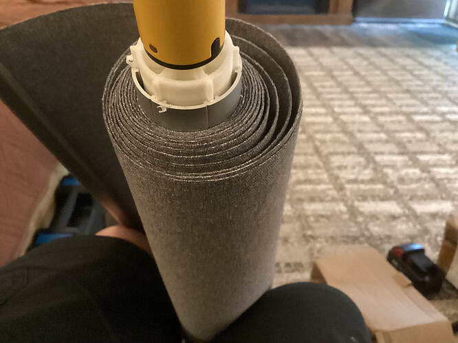

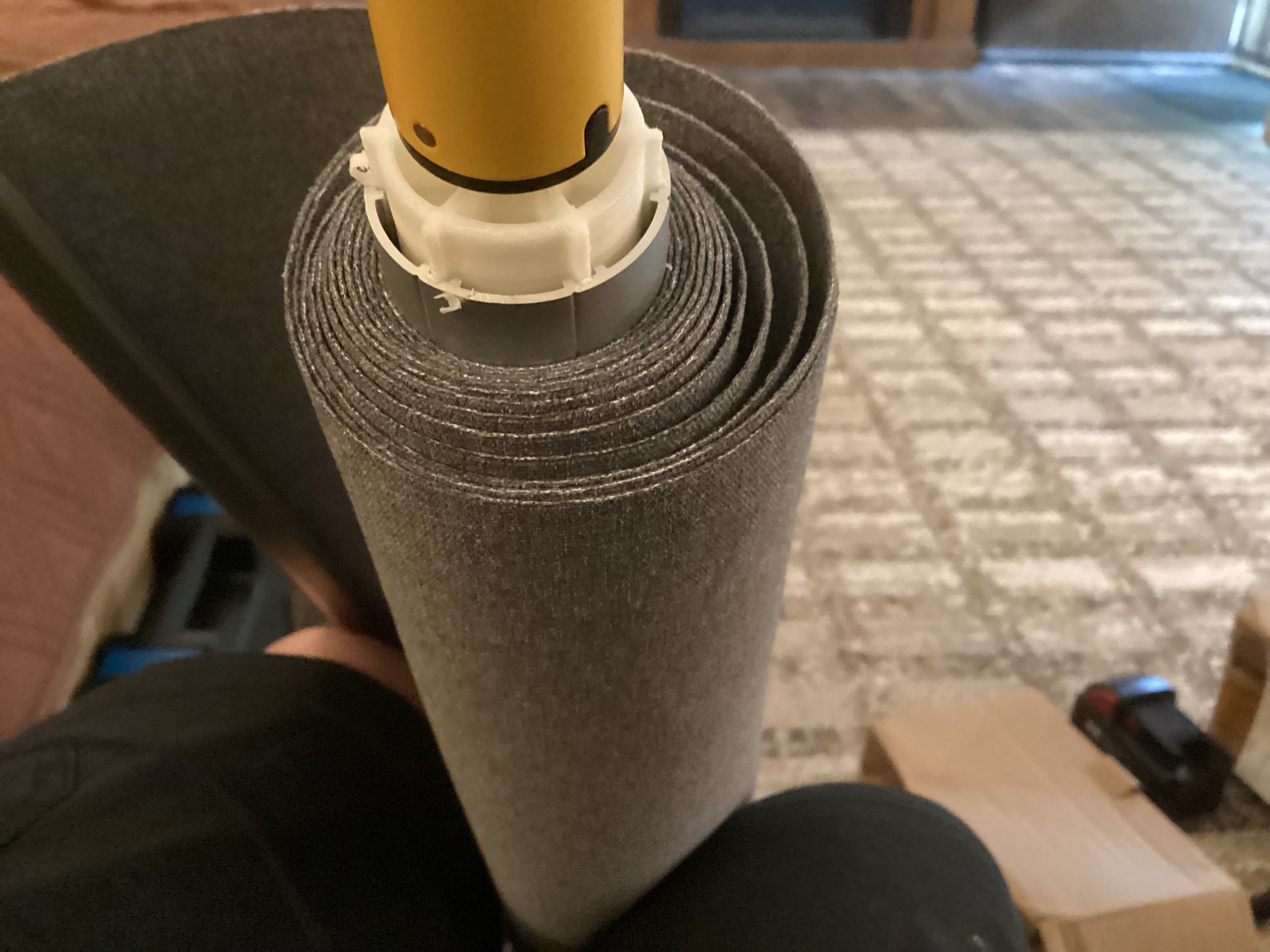

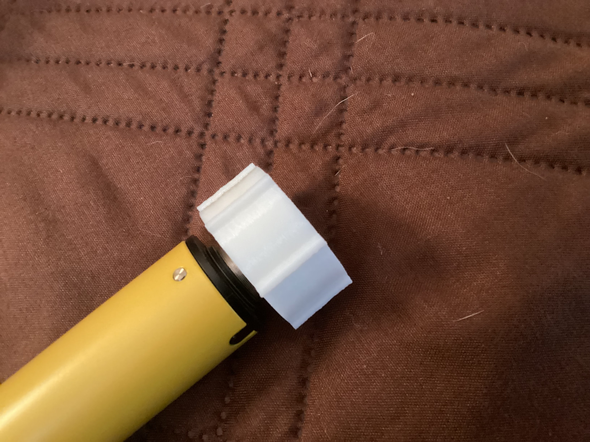

I was able to change the pieces but the drive end is a very tight fit. It started shaving the plastic. I had a time getting it out of the tube even though it was partially inside the tube.
I suspect a little sandpaper on the drive will make it slide it better. Waiting on a reply from Rollerhouse..

Rollerhouse said those are 3D printed and it is ok to shave them down a tad.

Second update. I used some fine grit sandpaper and sanded down the little pips on the drive. It went in snugly so I used a bit of silicone spray and it is together and paired with Hubitat.

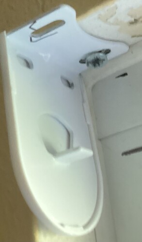

The brackets are too wide for my windows. I can only affix the bracket with one screw. Granted, the assembly isn’t that heavy but only one screw isn’t right. I can’t mount it on the wall because the curtain valance would hit it.
My thought is to cut the bracket and bend it at a 90 degree angle so one screw will be going vertical and the other will be going horizontal.
Or drill another hole in the bracket about 3//4” from the rear mounting hole.

I was trying to mount the blind inside the window with the screws vertical.
There isn’t much room, so I decided to move the mounts so the brackets are perpendicular to the wall. The valance rod needed to be replaced to make room for the brackets.

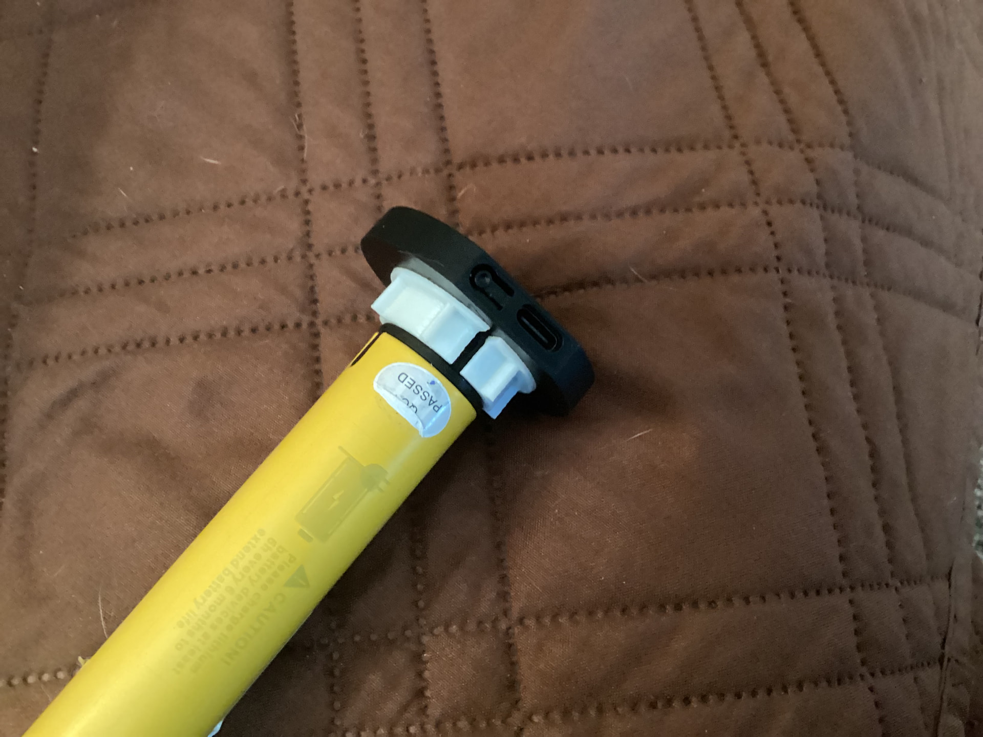

The first photo shows the motor’s USB-C charging port and pairing button, both conveniently located for easy access. It’s a thoughtful design that makes charging and pairing simple without removing the motor from the blind.

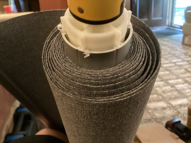

The second photo shows the IKEA roller tube fitted with the supplied 3D-printed adapter. On my unit, the adapter required only a light touch-up with fine sandpaper before slipping into place. Once installed, it fit securely and functioned exactly as intended. One mounting adapter incorporates a spring-loaded button that locks into the mounting bracket, while a tab on the other bracket engages the drive motor. The result is a secure, well-engineered installation.

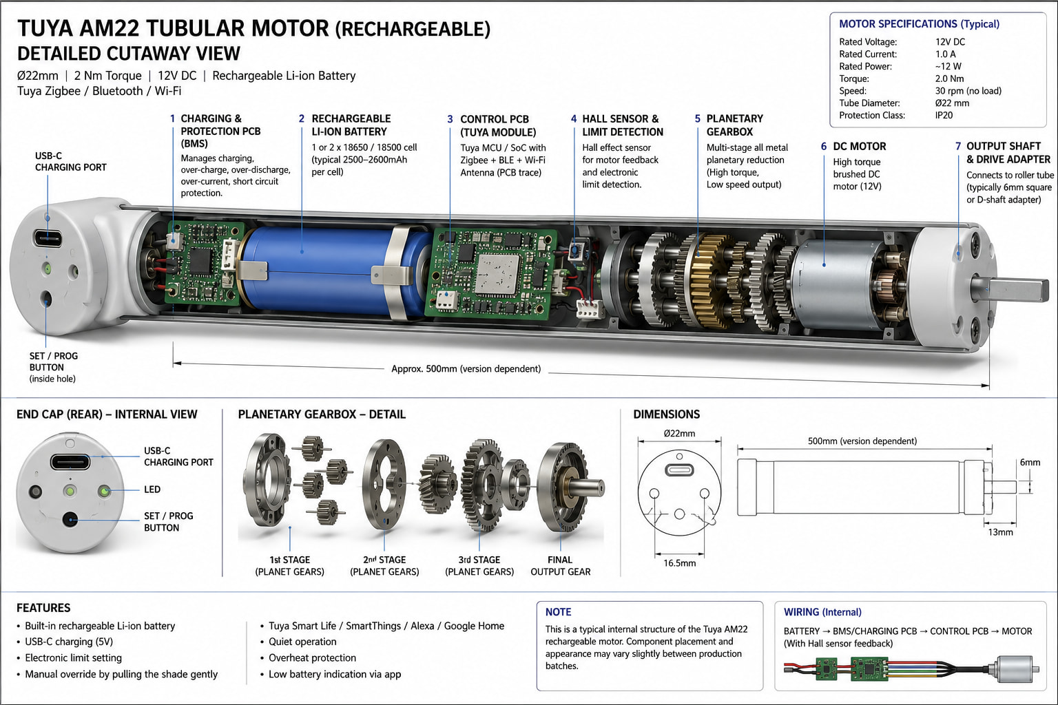

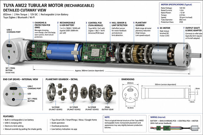

I asked chatGPT to show me what the motor looks like inside. This is AI generated because there are no engineering diagrams.
