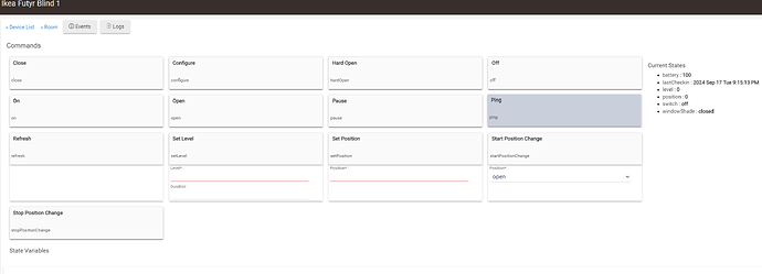

I didn't have to use your fix because I manually pinged it through the device page. Wasn't anything automatic set up.
If you ran the command from the device detail page and got that error -- not sure what you mean but taking a guess in the absence of any other information -- there is still a problem with the driver (albeit an unusual one, and not one that should affect anything else per se unless there are similar problems elsewhere).
screen
Yeah I just hit the ping button as seen in pic. Working fine though otherwise :man_shrugging:
OK, that isn't from a built-in driver, so you must be using a custom driver for this. Ignoring the command is probably easiest, unless there is a scheduled job the driver created that uses it; otherwise, asking the author to address the underlying issue (or doing so yourself -- or asking someone here if you aren't sure, but without a link to the actual code, there isn't much that can be done) would probably be best. Good luck!
I didn't catch this before, but there isn't a built-in driver by this name (though one of the Generic Zigbee drivers would probably work for this kind of device) -- adding to the clues that you're using a custom driver, which is also where the error in your first post would have come from looking at it a bit more closely.
Wow I guess your right I totally forgot that I ever installed this driver lol. Sorry for the confusion.
