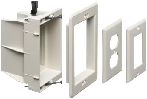

How about getting a reassessed box that you can put your own outlet in. Then throw in a outlet with USB ports and plug the tablet into that.

Ahhh that recessed DIY outlet looks like the ticket, thanks guys! And thanks for the link @chuck.schwer :slight_smile:
How about one of these recessed/angled outlets?
http://www.homedepot.com/p/1-Gang-Recessed-TV-Media-Box-Kit-with-Surge-Suppressing-Outlet-and-Low-Voltage-Inserts-White-TV1WTVSSW/304271154
That has potential... I think the single gang linked above, mouted horizontally, will work out ok. Ordered one a little while ago, should be here Saturday.

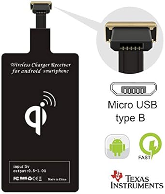

Well it would actually help with aesthetics. I planned to set up a mount using rare earth magnets so the tablet could be removed from the wall with a clean look. The problem was that the wireless chargers did not provide enough power to charge the tablets.

Edit: some of the items were no longer available. Added screenshot for one of them. And the faceplate is a 4 gang. It only show a 1 gang in the pic below for some reason.
Here was what I bought
https://www.amazon.com/gp/aw/d/B01LWLUYF4/ref=ya_aw_oh_bia_dp?ie=UTF8&psc=1
https://www.amazon.com/gp/aw/d/B01GO07YNU?psc=1&ref=yo_pop_mb_pd_title
The blank faceplate would cover the wireless coil and magnets. The tablet case would cover the other magnets and the wireless pad that was connected to the tablet. When the tablet was removed, all that would be left would be the blank faceplate...that could be painted the same color as the wall if needed. Seemed like a great idea but never got past getting the tablet to charge even when the coil and the pad were in direct contact.

Yes ...at the time I was building this, I definitely would have. It was a couple years ago when my daughter was very young and we also used the tablet with Tinycam to monitor as she slept. Mounted on the wall would be too far from the couch to properly see and hear her.
The only thing you would see after removing the tablet is the blank faceplate. Everything would be behind it. I even had plans to shave down the thickness if necessary but it's already so thin that I dont think that it would affect the wireless charging at all.
