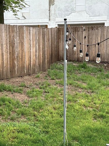

Dig a hole, 18" down 12" or wider. pour in some old rocks or throw some broken beicks or what have you in the bottom. Get 2" pvc and put it in the middle of the hole.. (use a $3.00 post level to check plumb). Put in a bag or 2 of Quickcrete Fast setting concrete (do this dry). Check your plumb on the PVC (it will be stiffer since it's in the concrete). Using a hose spray in a gallon or so of water. It will generally set in about 45 mins but really give it 24 hours.
Fill in top of concrete with dirt/grass. Cut off PVC about 3-4" above ground level.
Mount weather station to one of a 1-1/2" x 10' piece of galvanized pipe (painting optional). Take pipe slide it into pvc pipe. Will be a perfect fit.
Enjoy weather data.
Here is a shot of one of my posts. It doesn't sway that I've noticed. It doesn't have my Weatherflow on it but it would fit fine. You can just lift the post out when maintenance is needed.
