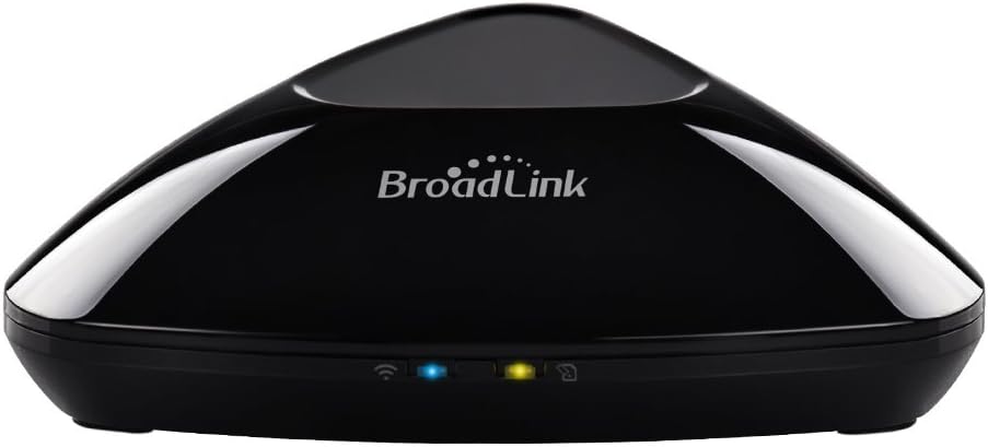

BroadLink RM Pro does it for a lot less. Sorry for a shameless plug, but I happen to have one:
how is it connected to Hubitat?
Broadlink RM pro would require internet at all times, right?
This model works locally with Hubitat. There is integration here somewhere. It isn't being updated, but works.
unfortunately it seems like the code was also pulled by the author :S I was reading the thread and it seems like the author disappeared and deleted the code.
I, as well as many others, have the necessary code and are not precluded from using it. I have it running right now.
I see. Thanks for the tip. It seems like Amazon Mexico does have the RM MINI3 in stock. It may actually work!
