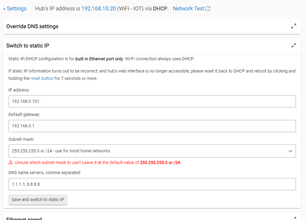

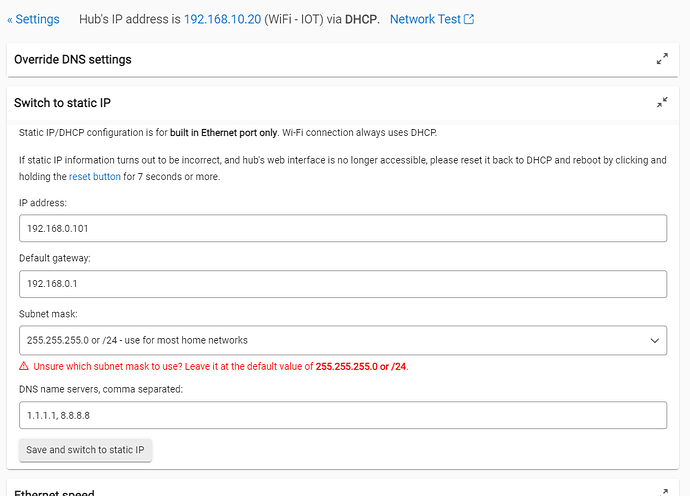

Here is a capture of the static IP settings for my main hub after a bottom button reset and a soft reset. The settings you see are wrong and I cannot change them.

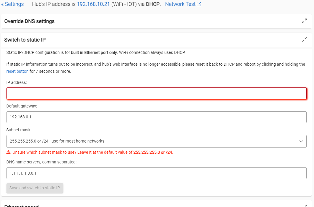

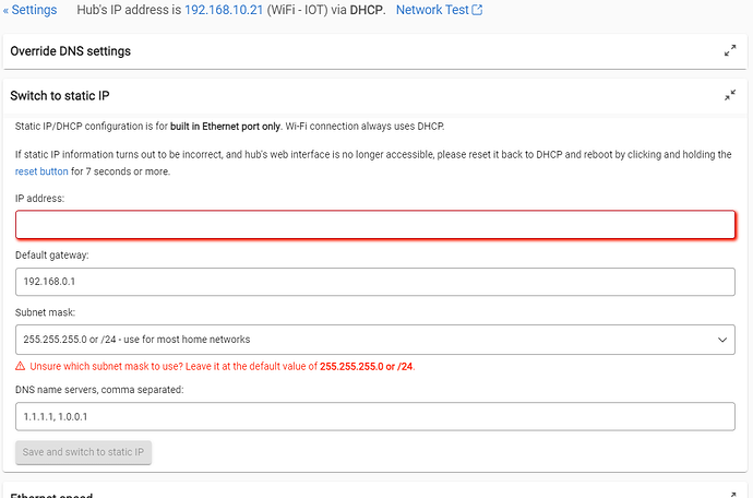

Here is a capture of the static IP settings on my barn hub. These settings don't seem correct either but not as bad. Also I cannot change them.
At the top it's saying what IS. What your hub is using at the time of that screen cap is 192.168.10.20 via DHCP over WiFi.
You have a screen full of prior customizations :slight_smile: that will take effect IF you click that "Save and switch to static IP" button.

and for your Barn hub, the potential changes are not fully filled out, so it would presumably bark if you tried to click the "Save and switch to static IP" button.

Presumably you know this because those 192.168.10 addresses (20 & 21) are what you're using in your browser to display those pages. You are NOT using 192.168.0.101, which is what you entered once upon a time.
So I should ignore the seemingly random settings. I was hoping that I was on to something. If the network settings are correct then I am no closer to solving my Hub Mesh problem.
