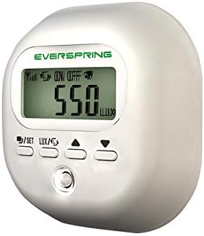

For dedicated sensors that are on the compatible devices list, you can still get the Everspring Z-Wave sensor.

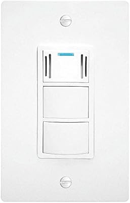

I would probably go with the Panasonic dumb sensor I listed above if I were to do it over.
