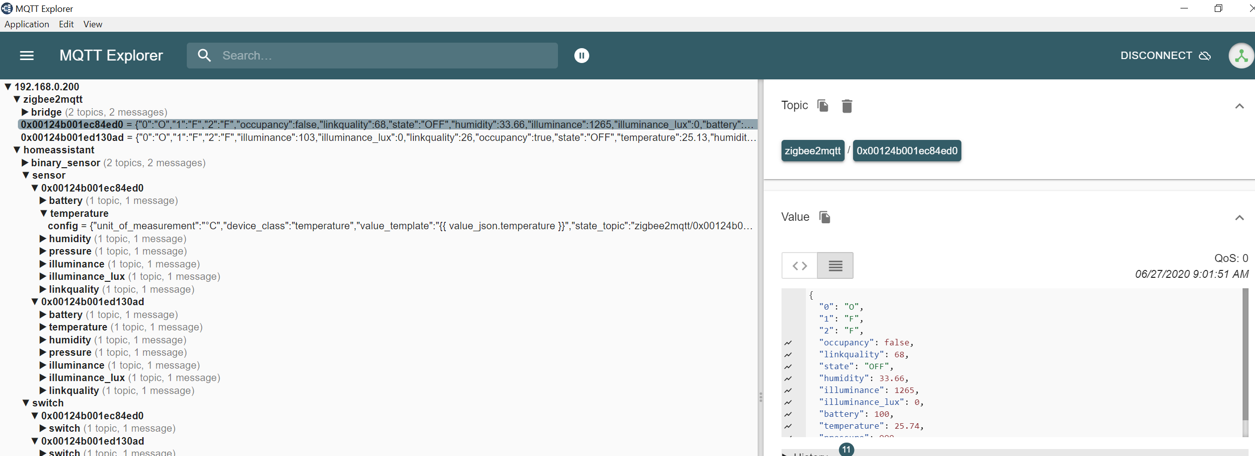

Hi Everyone,
I just want to let everyone know that I have started work to get my sensor working in Zigbee2mqtt.
Here is the project https://www.zigbee2mqtt.io/
As mqtt support in Hubitat is coming a long very well, if any member here may have the need to run my sensor in Zigbee2mqtt for some reason, I want to make sure that it will work. The feature supported is not in parity to the Hubitat DTH. However, the core Light, Temperature, Humidity, Pressure is working as expected. The maintaner of Zigbee2mqtt is nice enough to merge my pull request at this moment.
Here is what it look like from mqtt explorer.
Iman

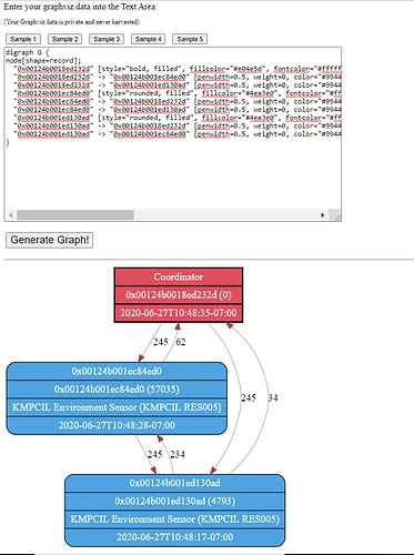

Is that the same version that would allow a Zigbee network map to be produced..?
https://github.com/Koenkk/zigbee2mqtt/issues/417
Yes, it is. But, you are ahead of me on this one. I have not tried the mapping feature yet.
Let us know how it goes... I was reading about it earlier and then you posted what you was doing with Zigbee and MQTT so intrigued as to how that plays out...
@nutcracker, The map is very cool. It works by publishing to a topic. You will get back JSON of your network. From the linked url, you can get the graph by entering that JSON.
I suppose that the above process can be automated and displayed in Doashboard.
This is what it look like with my test setup.
