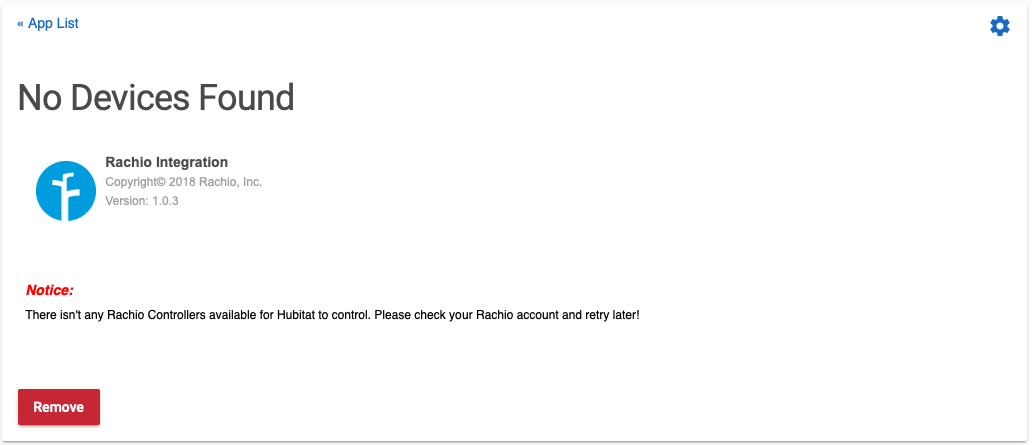

I updated to HE 2.2.5.120 and have a few problems. This is a bug report that the Rachio Integration is broken. When I launch the Rachio Integration app, it reports "There isn't any Rachio Controllers available for Hubitat to control."

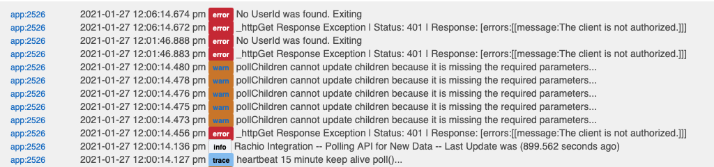

Notice in the settings for the Rachio Integration, the app switched from using "userName" which I have set, to using "userId" which is not set. I would expect the new app to migrate the settings and state values to the new ones, and to clean-up the old values after migration. This does not appear to have happened. To further complicate the issue, there is no way to re-enter credentials, and re-associate the app to my account.
I updated to 120, I did not update to 119. I don’t know at what point it was, but as of this release, the j refraction uses userId, but in a prior version it used userName for the Rachio login. I understand yours is working. It these posts completely dismiss the facts, which is that is the applications settings page, I see an empty userId and a populated userName, which coincides with the log entry that the userId cannot be obtained. When changing a driver, it makes sense to allow the older state and settings, but at some point the old ones need to be retired. When this occurs, the new ones should already be populated.

This refusal to acknowledge the flaws in your code is just beyond ridiculous. Just look at the very first screen. Are you telling me, that it is by-design that once you authenticate with the service, if anything should happen to break the authentication, that it is okay to have to Remove and re-install the app? that the only button in the app should be "Remove" ?

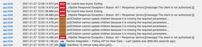

That said, I will note that the logs held quite a few of these entries PRIOR, which is what triggered my investigation in the first place: pollChildren cannot update children because it is missing the required parameters
