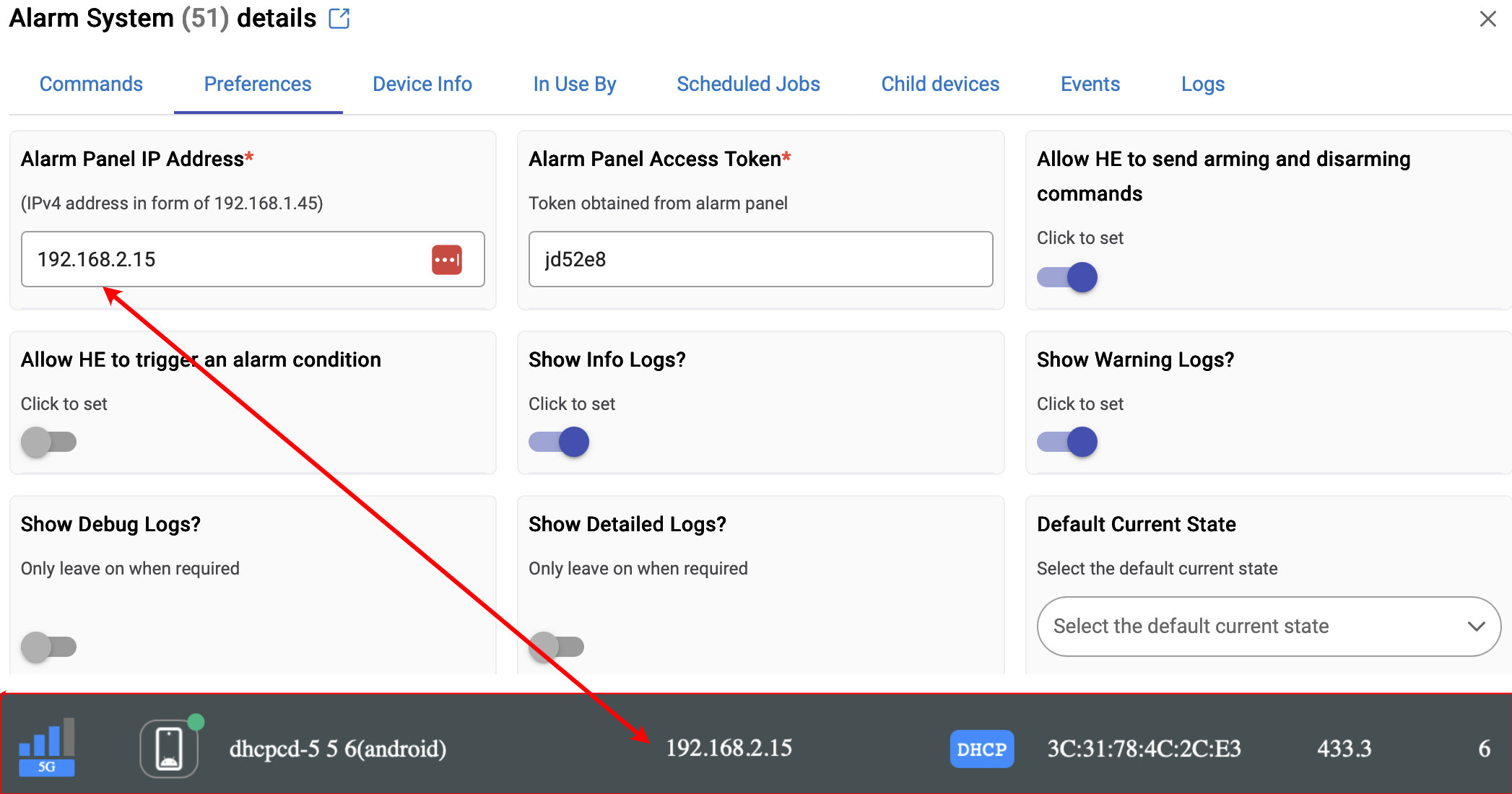

I am not sure if this is the correct forum for help with this user app, but I try. I have this app running on the C8 PRO bridging to Homekit. I can see the sensors in the C8 and in Homekit, and they are working. The commands, however, do not work - ARM STAY, DISARM, etc., and they do not show up in any way on the Homekit app integration page (shouldn't they?). The Device>Commands tabs says they are sent, but nothing happens. The current status reported is also always DISARM even if the IQ4 panel is armed.
Here is the top of my log, but I am certain I have set the correct IP address:

QolSys IQ Alarm Panel: IP Address of alarm panel not configured
