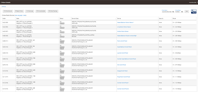

Edit: Here is the screenshot of the rule.
It doesn't crash as such but behaves weird as some rules don't work and others seem to be delayed. I just did a backup and restore and it didn't fix it but the first time it did.
