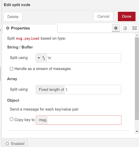

Try this:
JSON
"id": "97f64ca.d04b7b",

"type": "splitter",
"z": "97f64ca.d04b7b",
"name": "Split payload array",
"property": "payload",
"x": 850,
"y": 420,
"wires": [
"7891807e.90163"
