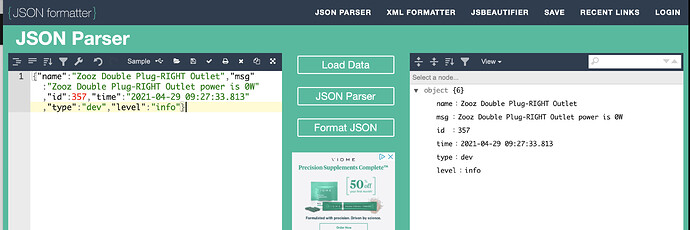

Thanks for putting this together! I have my setup as described in the first post, however, none of the values are being assigned. In the debug tab I get the message below for every message that comes through the WS. I don't think that I have made any typo's but I pasted the function below just incase my eyes aren't catching something. Any help with this is much appreciated.
4/29/2021, 9:27:33 AM[node: 30458c1a.88e6a4](http://10.0.0.195:1880/#)INSERT INTO logs(`name`,`msg`,`id`,`time`,`type`,`level`) VALUES('undefined','undefined',undefined,'undefined','undefined','undefined') : msg.payload : string[160]
"{"name":"Zooz Double Plug-RIGHT Outlet","msg":"Zooz Double Plug-RIGHT Outlet power is 0W","id":357,"time":"2021-04-29 09:27:33.813","type":"dev","level":"info"}"
var query = "INSERT INTO logs(`name`,`msg`,`id`,`time`,`type`,`level`) VALUES(";
//var name = msg.name.replace(/'/g, "\'");
//var msg = msg.msg.replace(/'/g, "\'");
query += "'" + msg.name + "',";
query += "'" + msg.msg + "',";
query += msg.id + ',';
query += "'" + msg.time + "',";
query += "'" + msg.type + "',";
query += "'" + msg.level + "')";
msg.topic = query;
return msg;
It looks like the "double quotes" on the return msg.payload may be throwing things off? If I put the msg.payload in your post through a JSON parser, this is the error message.
However, if I remove the opening and closing "double quotes", it parses it correctly.
Thanks for the inputs! I am new to Node-Red so forgive the questions. I am not sure where the extra quotes are coming from in the function. In the debug message, I thought that the bottom line was the output of what was coming from hubitat.
I think what is happening is that msg.payload is coming out as a string (for the entire JSON object) and because of that it is enclosed in quotes.
Screen Shot 2021-04-29 at 10.42.11 AM
If you put a debug node right after the Hubitat Logs WS node and look at msg.payload in the debug panel, I think it will show you the attribute you are getting is msg.payload (as a JSON string) and not msg.name, msg.msg etc.
I don't use websocket data (I use the Hubitat node) so not sure why the attributes are being sent as msg.payload (string) vs. msg.name, msg, msg etc.
I just created a test flow and confirmed that what is coming from the WS listener node is a string and not a parsed object. What you need to do is modify the configuration node that the WS listener is subscribed to and change the "send/receive" selection from "payload" to "entire message"
The output will then be a correctly formatted JSON string. Hope this helps.
Awesome! That was it. Thanks for your help! I've been racking my brain over this for two days. :smiley:
