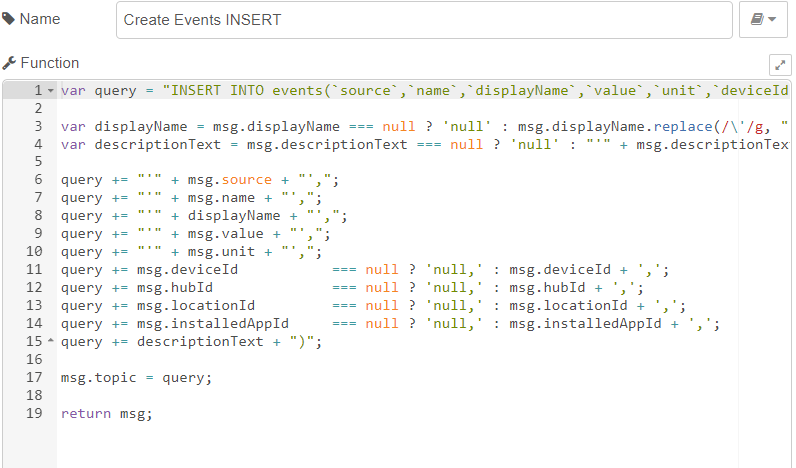

I've got two hubs, but currently am only logging one hub. I noticed that there is HUB ID in the database, that is empty.
Where would I update the hub id?
The orange text, the green text, or elsewhere? (Obviously under hubId - line 12)
Iβve edited mine a bit. Do you have a set values function before that one? Itβs on first line.
