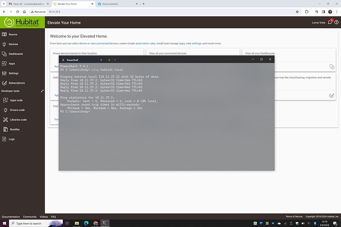

Well, I have never actually tried using hubitat.local before so I gave it a go.
On my Windows 10 machine, it worked fine. I type in hubitat.local into my browser and it took me directly to hubitats page.
I ping hubitat.local and it successfully resolves and pings.
This is the baffling part- it works on some Windows installations but not on all.
