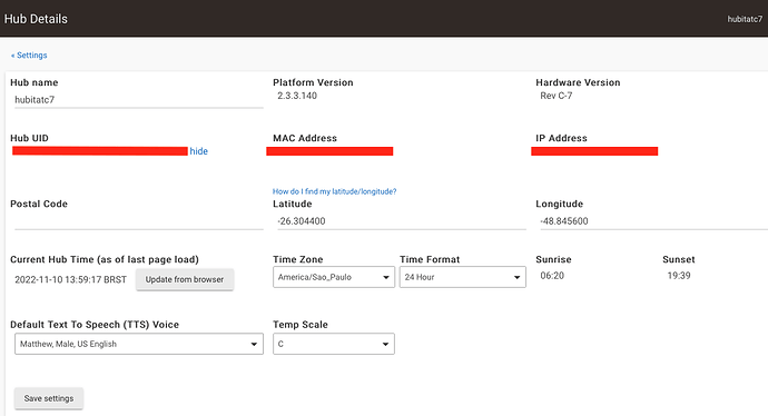

My correct timezone is America/Sao_Paulo. Yes, I can update time from browser and it becomes correct for a while. But something makes it move 1 hour forward. I'm not sure when (after midnight?)/what system service is causing this... Screen grab below shows correct time in system, after I clicked the Update from browser button.

According to Google, your time zone you have set is Brazilian Standard Time, which is GMT -3, Current time is 2:21PM (14:21), so the time in your screenshot looks correct for when you posted it. Not sure if that is from your forcing the browser time or not?
