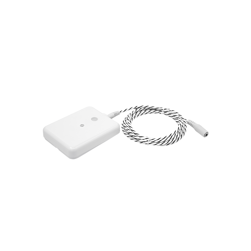

Does this Dome sensor is a cable type sensor that you can put around the foot print of the heater?
I saw this link in another post. I'd think you'd want all the advance warning you could possibly get, with it being in the attic:

Yes it has a remote sensor that sits in the pan. I now know I need to move the sensor to another area of the pan to get an earlier warning.

Those Dome sensors are the best. I hated mine when I first got it, but I think the driver was funky or maybe device was not properly intialized. However now, they are the kings of reliability and battery life. In my second place are the Fibaro flood sensors(IIRC I hated these also at the start), although they are huge, very reliable and do flood, temp and acceleration (vibration)
