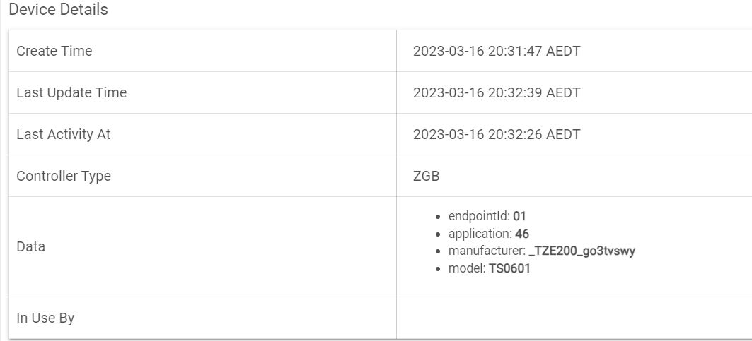

I'm migrating my devices from Smartthings to HubItat which was going seemlessly until I hit my Makegood (Tuya) switches and power points bought from Oz Smart Things.
I've tried both stock and custom drivers without much luck. I have the 2 and 3 gang wall switch and the double power point, admittedly i did have dramas integrating some of these in to Smartthngs due to the EF00 cluster.
Has anyone managed to get these devices integrated to Hubitat, any advice and guidance would be appreciated.
Your device fingerprint is not there, but you can try changing manually to this driver, then hit Initialize button. Press F5, the driver should create 4 child switched by default.
If it works, I will add your model into the same driver.
With ST data points 1,2,3 were the swithces with a couple of other datapoints for Voltage and current measurements. I'm only after the switch functionality really though.
You can update the driver from the same link, I have added the 1-2-3-4 gangs Oz Smart light switches.
This is a very simple driver handling On/Off commands only. I think there was a better driver for double/triple GPOs that provides also power reporting, but I am not sure if it works with Tuya's EF00 cluster. You can search this AUS/NZ thread for it.
You are a star @kkossev, I now have my 3 switches back in operation on Hubitat. I will have a play with my other Makegood devices tomorrow. I really appreciate you taking the time to help me out, thank you,
