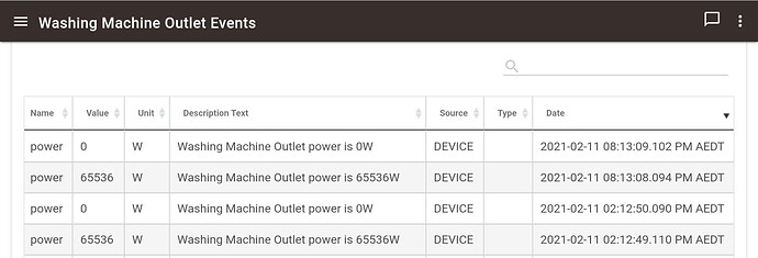

Got another odd reading from my smartthings plug.
Machine wasn't even running! :grinning:
Thats alot of power for a machine not running...lol
Yeah, that's the reading I was seeing when I setup my Samsung plugs. I thought it settled down when I moved to the GE driver, which I think Mike Maxwell suggested at one point, but I don't think that has been the case for me.
I was hoping they may have fixed it in 2.2.5....

Theres an iris smart plug driver found which was suggested somewhere in the forum. Only just changed to it, so will report back soon!
