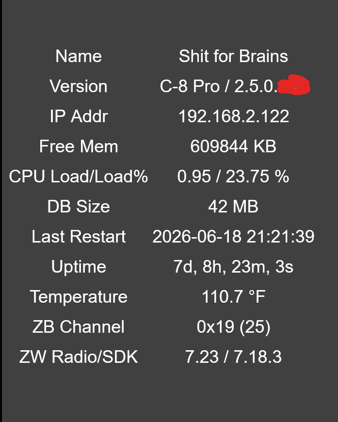

general is around 110f-120f I think. Mine holds at 110 and doesn’t vary
Where is that info display located that you screenshotted, showing the C8 temperature? Is that a built in info panel, or an app?
It’s a driver
Are you asking what the hottest room could be? (AMBIENT = room or surrounding environment temperature?)
Or what the max operating internal temperature is? The latter is what is shown on the image that @rlithgow1 posted
The former has been discussed several times. Hubitat doesn't list those specs. But, the consensus is it would be the same range as any other computerized operational specs.
Handy. I have the driver installed, but I didn't realize I had to change the temp polling in preferences to get the temp attribute.
Now that I done so, I'm at 138.2 F :open_mouth:
I'm not surprised, this is my overloaded C8. The C8 Pro is still sitting on my desk, waiting for me to get around to doing the migration... Maybe that will happen this weekend :confounded_face:

It is on the top shelf of a small hallway closet, along with my router. I just checked, it is currently 80F in there right now. It seems to get some heat down from the attic above it.
I guess this is high for CPU as well, as is to be expected in this case. Currently any real load on the hub will put me in hub mode severe for a few minutes, then it settles down. Hence why I bought the Pro, that I really need to get around to migrating to sooner than later.
Wow, yeah, that doesn’t sound good. If it’s 50+ degrees hotter than its environment, I expect it wouldn’t survive a 110F interior for very long at all. Dang…
