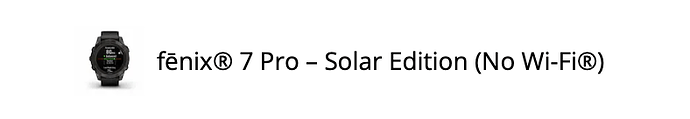

Sorry @theisgroup, I should have checked before I replied earlier. Fenix 7 pro solar should already be supported.
Is it not showing up for you?
I’m not seeing it in connectiq
