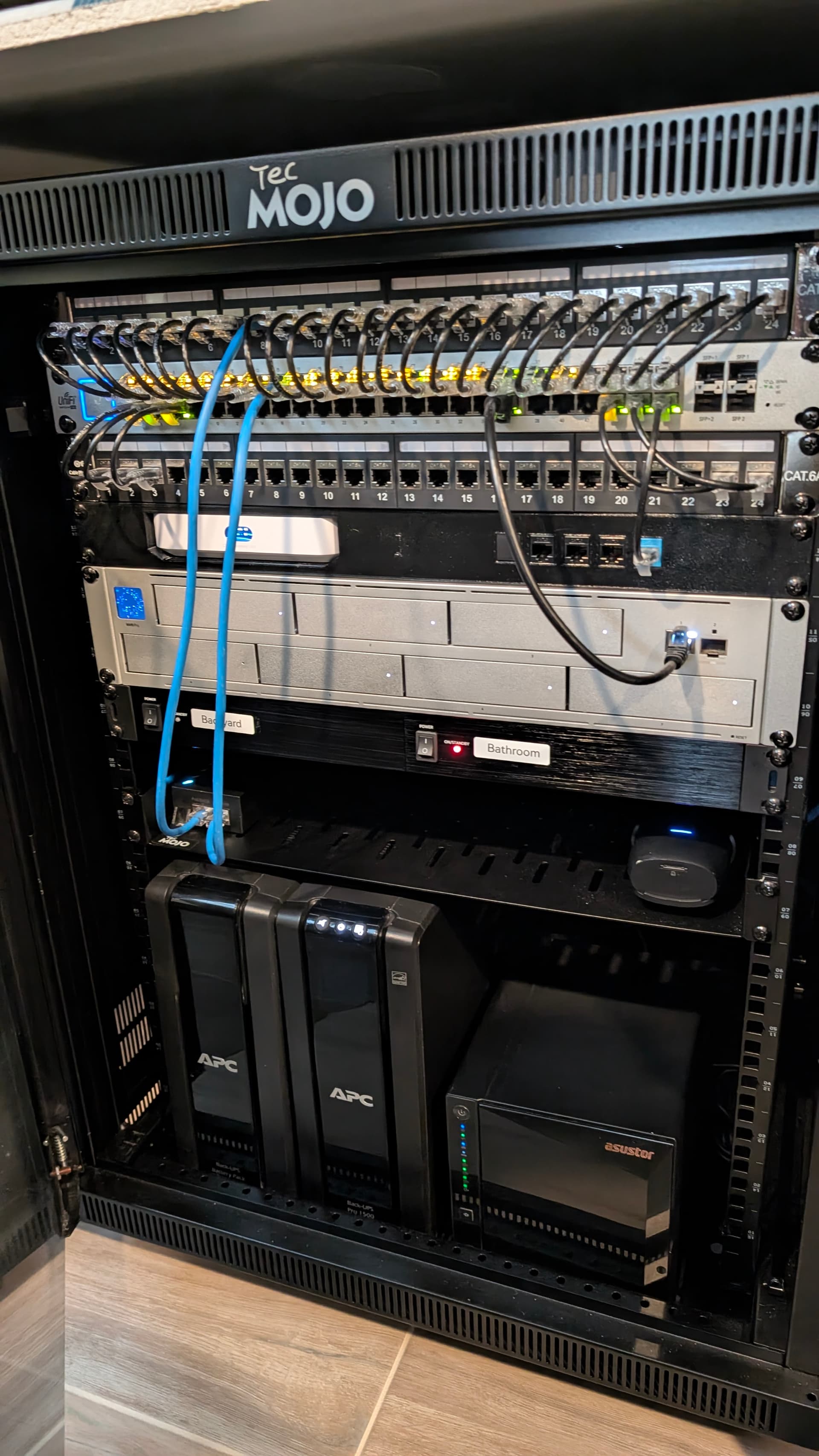

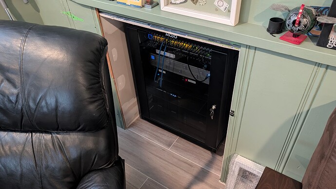

For those interested, this is what I built in my office. I cut out a section of the wall that backed up to a crawl space and made room for a rolling rack. It's about 80% done, just a little trim work and painting left. I am rather proud and happy with the result!

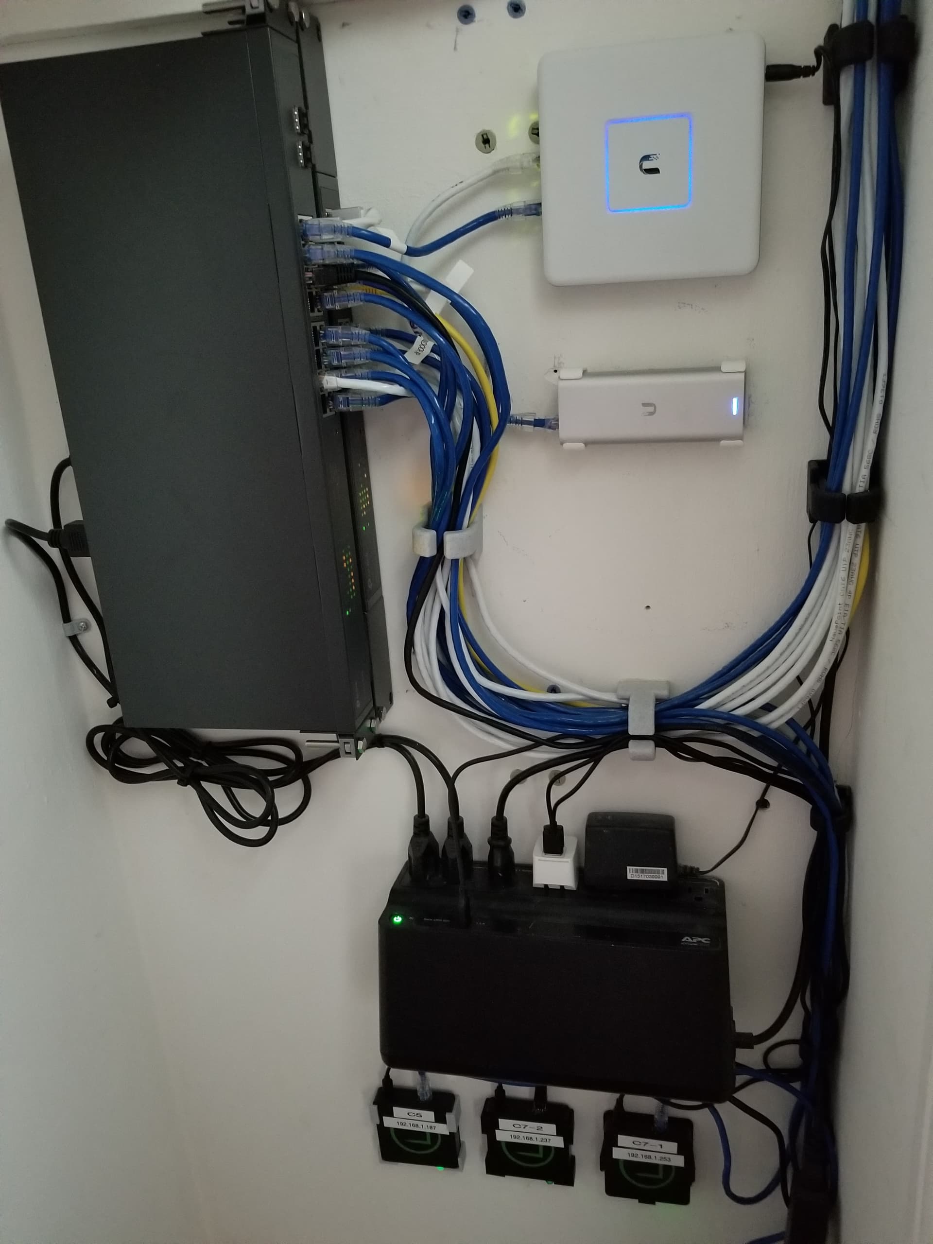

This is the mess of a closet I was dismantling, but its an old photo with different gear.
Would love to do a proper enterprise style data closet. Proper cabling. Even a NAS. Kudos. You might want to consider Eaton rack mount UPS. They have a PF of 1. Those tower APCs are closer to 0.6
It will also take up a lot less space. When I need to add one more rack mountable piece of gear I'll be forced to change the UPS. It's just what I had laying around and it's got a really big battery; the network and cameras can stay online for about 2 hours. Until I need the rack space it's difficult to justify, but it is inevitable. Thank you for the kind words.
