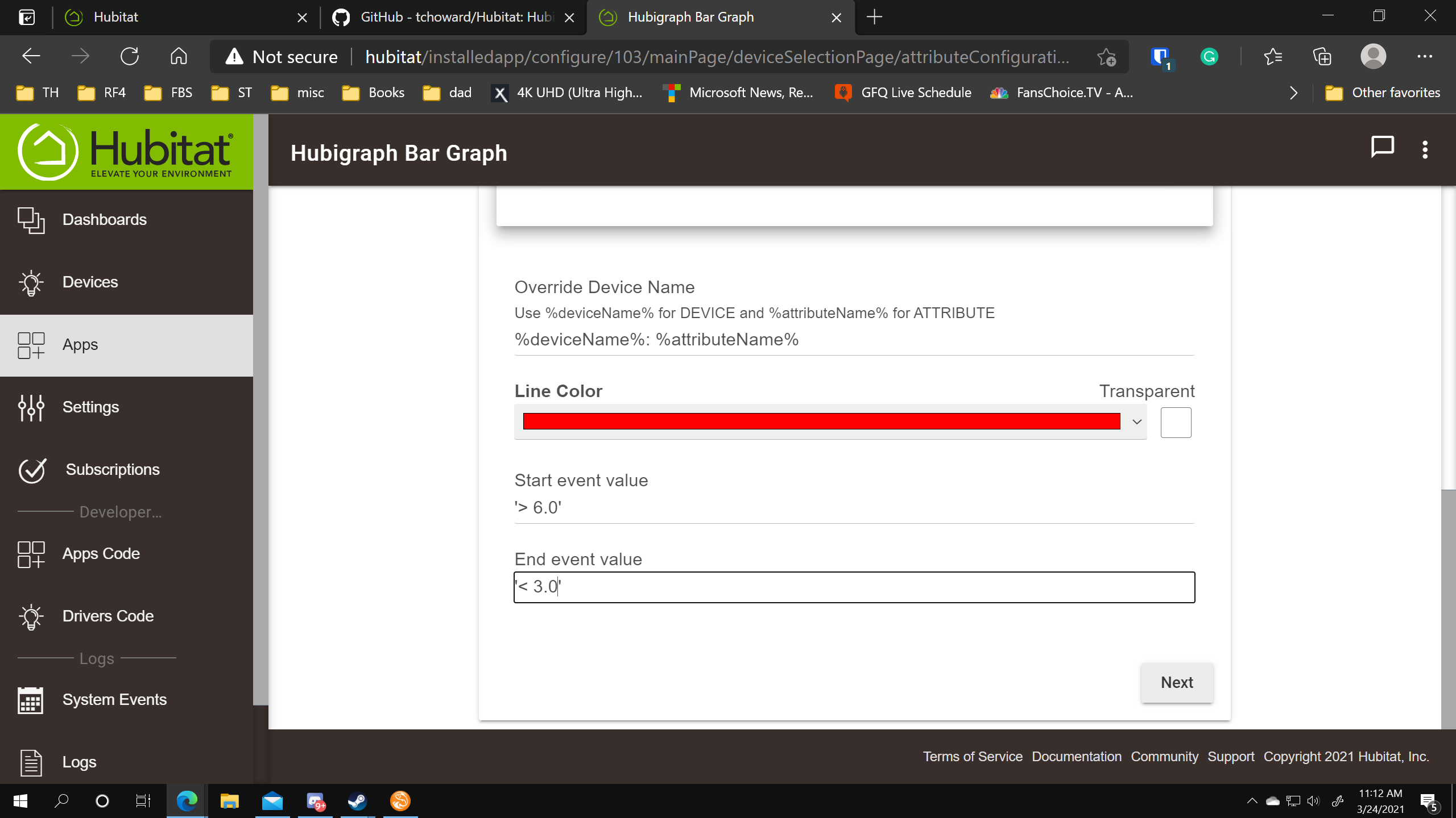

IF I am looking at power
would that be 6 or greater for start
also, I can not find the correct type for the tile

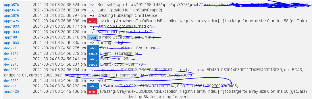

I upgraded today to latest version and get these errors when creating a time graph from new
turned on logging and open up a child
I’ll get a fix; that is really saying there is no data…

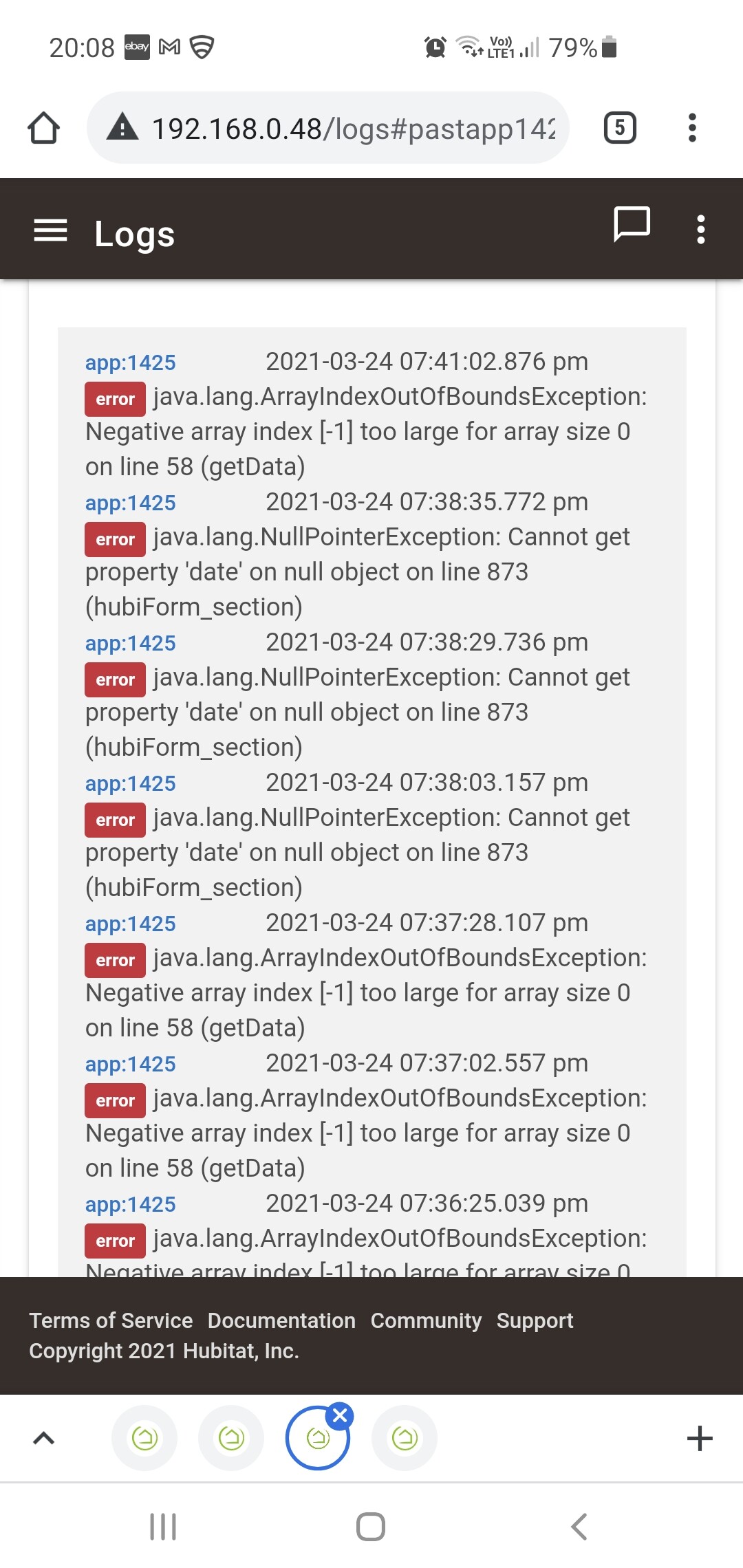

still getting this error, every time i opening the LTS child app
2021-03-26 09:19:40.777 pm errorjava.lang.NullPointerException: Cannot get property 'date' on null object on line 871 (hubiForm_section)

Fixed it
OLD LN 864 if (fileExists(sensor, attribute) ){
NEW LN 864 if (fileExists(sensor, attribute) && readFile(sensor, attribute)?.data){
don't know if its the most elegant but further on the json , data ,size was showing nulls
[size:3, data:[]] , [] , 3

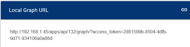

My IP of my hub changed....how do i update hubigraphs it was ending in 45 but now ends in 118
