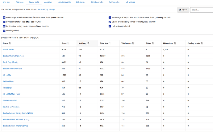

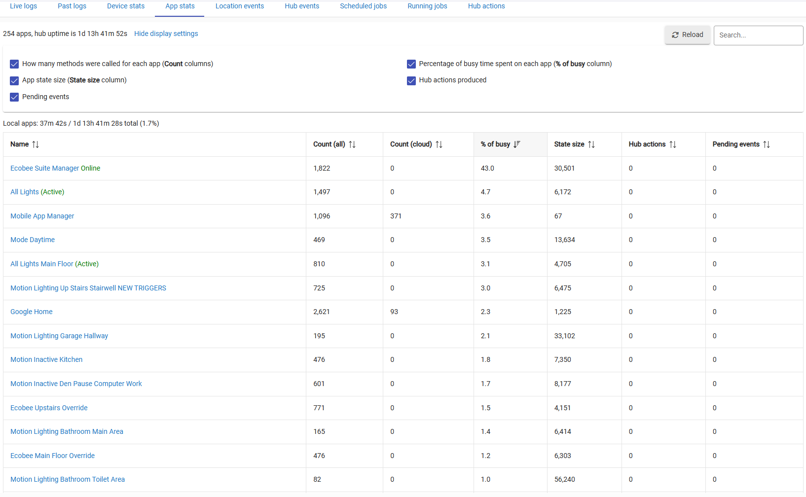

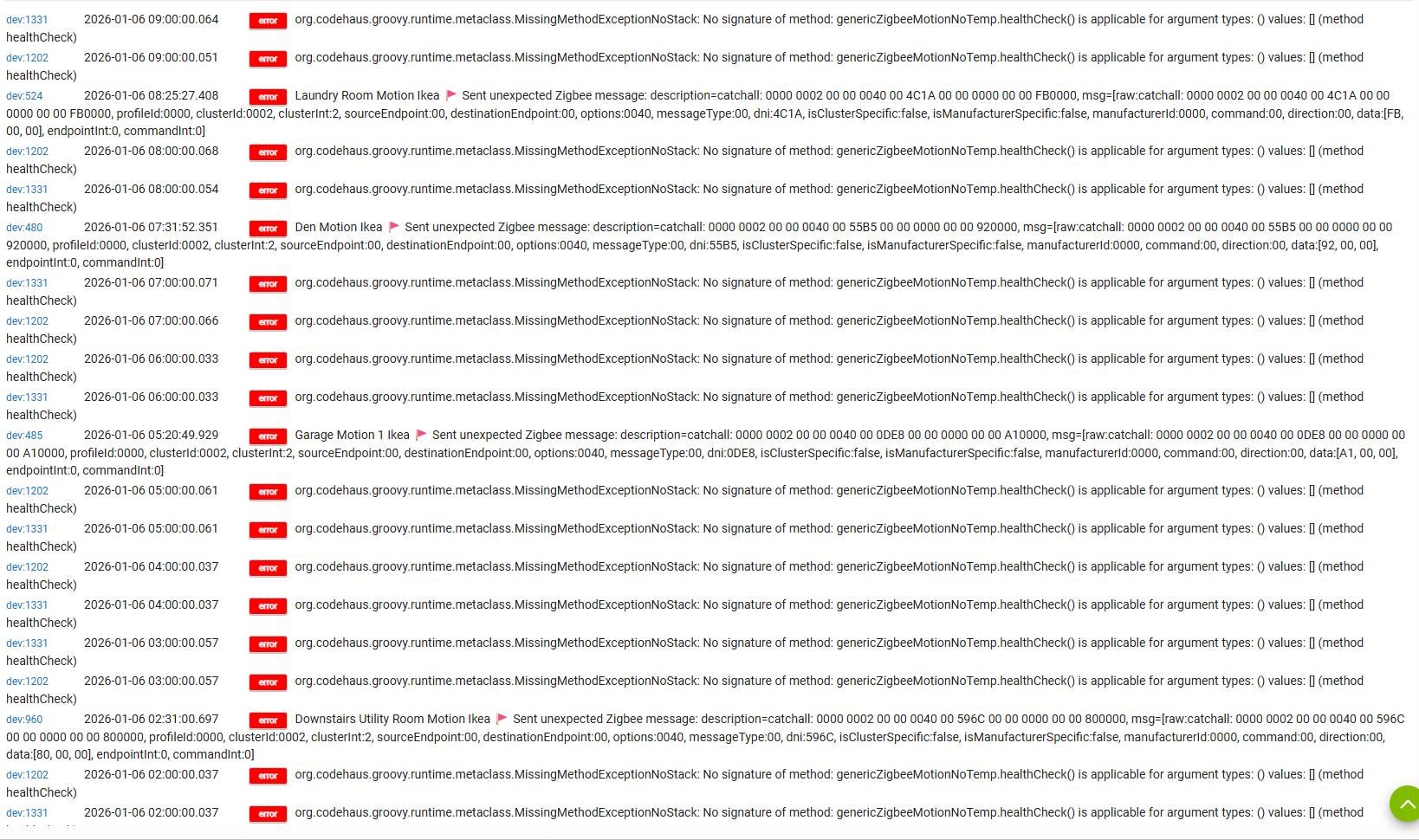

I keep researching and just can't find my specific issue or how to track it down. I had a C7 that ran (mostly) flawlessly. I had no issues for years until I installed Ecobee Suite for expanded capability. Then I started getting elevated and load severe errors; and started getting unreliable automations. I tried to trouble shoot it for a while and was told the Suite was not the cause. Ultimately, I couldn't get the errors to stop and uninstalled after about a week and a half. The errors immediately stopped and everything went back to normal. This was about a year or so ago.
About a week ago, I upgraded to the C-8 Pro. Had a few issues with google home, but ultimately, everything worked ok with no issues. I thought with the extra memory/processing on the C8 pro, I could go back to Ecobee Suite. Today, I started receiving elevated errors and I'm now in load severe. I LOVE the capability of ES but it doesn't seem to work with my setup (for whatever reason). Can anyone help track it down? It may not be ES this time, but this is very similar to what happened last time.
I am getting these errors for some reason as well, which weren't there on the C7.

Didn’t dig into all of the log entries, but th “health check” entries are likely caused by a ‘leftover” scheduled task from some driver you previously had installed.
Once you stop that scheduled task those errors will go away.
Go into Logs menu, Scheduled Jobs page, find the one for your device that is showing this error and kill it bu clocking on the trashcan.
If this is the driver you are using, you might want to post on the release thread there for the developer to see it.
