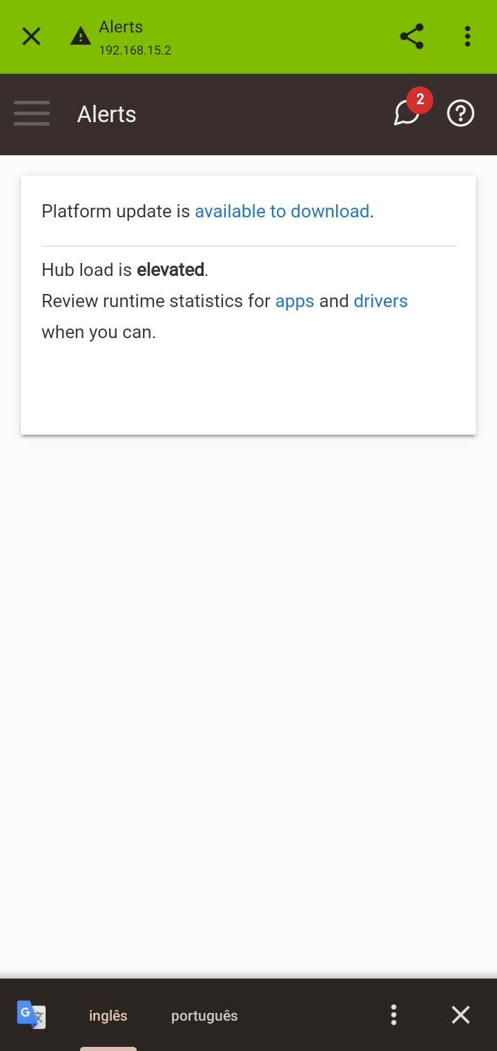

Good afternoon, I have hubitat C7, in version 2.3.7.144, the automation is taking a long time to happen, I receive information that the hub load is high. I don't know if the option will be reset.
The first thing I would do is exactly what the screen suggests, review runtime stats for apps and drivers. The page provides links to these, or you can go to Logs > Device Status and Logs > App Stats yourself. Reviewing "Past Logs" for errors in general may also help.
Also, it may be helpful to try some of the steps presented in this post (which it should have shown you before posting), including the database rebuild, as well as provide as much of the requested information as you can if none of the above helps:
Finally, it seems like you are on the beta but have not upgraded. If you are interested in testing, you can see if any changes in that version help you by upgrading. (I am not saying they will.)
