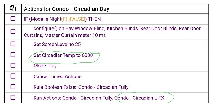

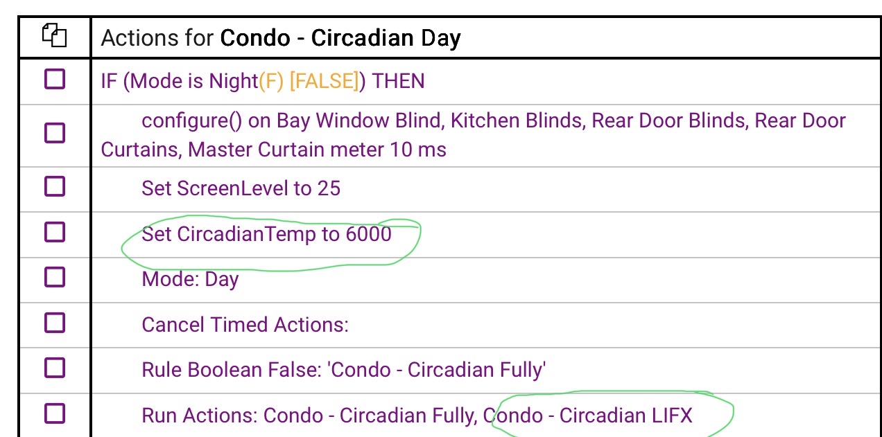

I would start here, it’s an excellent primer, but short answer… it’s very doable. I have circadian automations the set global variables for dimming and color temp. then calls the automations that changes the bulb dim and color temp based off the set global variable.
In this example i’m setting a global variable for the color temp of my lifx bulbs then the calling the automation to set the color temp based off the global variable.

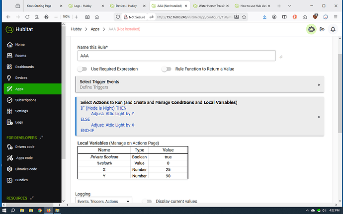

As mentioned above, this is certainly possible. However, the linked post is a bit old; Rule Machine (now "Rule Machine Legacy") once had an app-level feature called global variables, but now there is a feature called "hub variables" that is accessible to any app that chooses to add support for them, including modern versions of Rule Machine.
In a Rule 5.1 rule, you'll find various actions for setting or using the value of hub variables. The rule above is a modern rule that uses such a feature.
Rule Machine is a pretty complicated app, so if you're completely new to it, you might want to start with smaller, simpler rules just to get the hang of how it works. Some other apps can also use hub variables, not just Rule Machine (like "old" Rule Machine global variables), so you might not need to do everything there. For example, Room Lighting can use them (but not set them, so you'd still need something for that -- but these would probably be separate rules, anyway, unless you're setting it manually).
