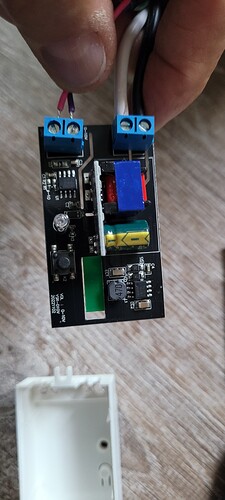

You could look around, I always use Alix due to easy returns/refunds. This devices seems fine and only uses the 110 volt to run the zigbee board and vary the 0 to 10 volt signal, so it's not like you'll be pushing high amperage through this device. The light itself is what will be drawing power from its own separate power cord so you have a very small load on this switch.
Here's the innards
