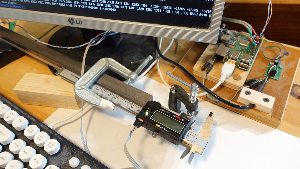

Here's one solution for one type of sliding door lock-state detector for a particular type of sliding door:
