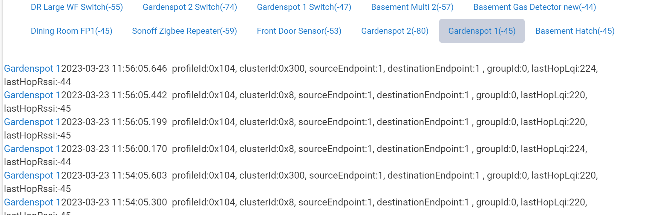

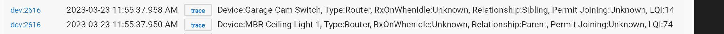

also weird/strange one of the problem devices near it.. the outdoor lights thourgh the wall in the room i put the repeater in that sometimes dropped messages, it doesnt show it routing through the sonoff in the logs but its stats in the zigbee logs went through the roof?
