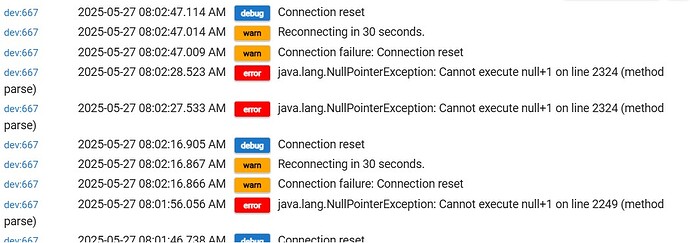

@Ranchitat The driver worked as you said. However, the Uni Plus doesn't report voltages consistently. Here is a screen shot of my parent log for the device.

There were an issue caused by silent report structure change around 1.5.x firmware. it is already fixed. Just update the driver to the latest version (trough the main page).

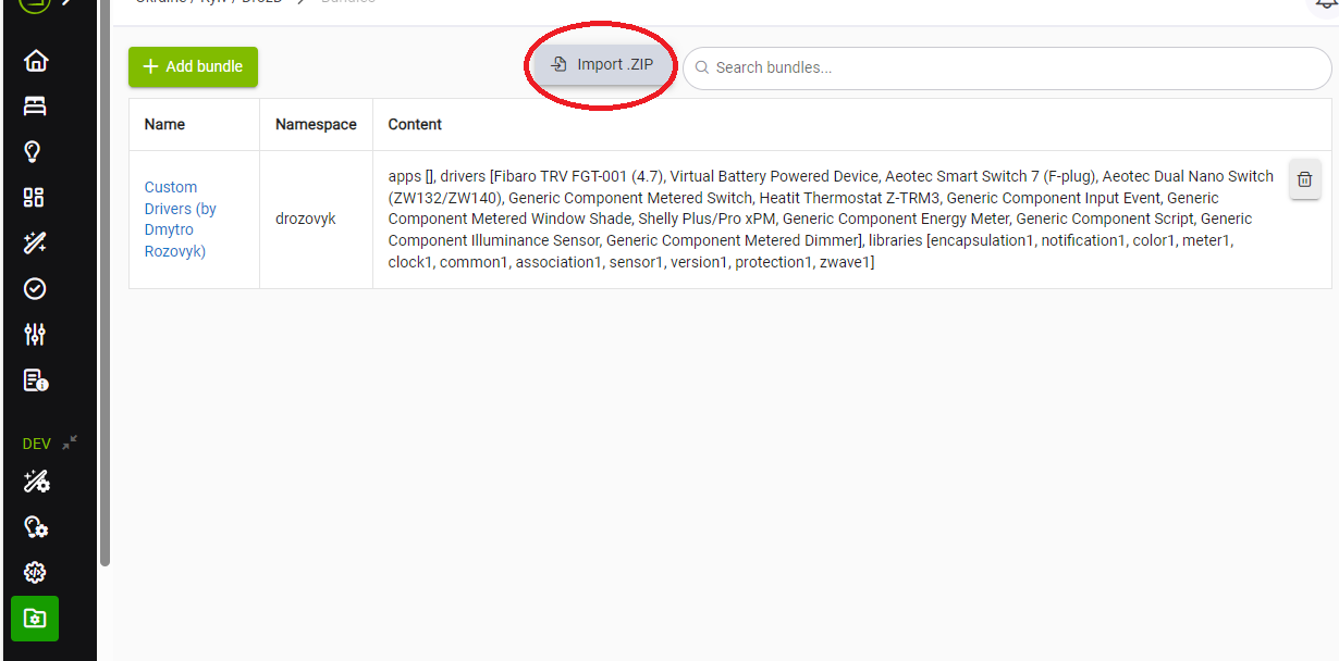

Thanks for the update. I'm running 1.6.2 firmware on both uni plus's. How do I get the bundle or the drivers into HE? I just feel a bit stupid honestly.
There is a link on that page that leads to the zip file. Or you can navigate to the 'bundles' folder.
Or ge4d / hubitat-code Bundles / Bundle1.zip — Bitbucket [there is a download link].
If you copy download link (by rightclicking on the 'Download file' hyperlnk) you can pass it directly to the hubs 'Bundles' page.

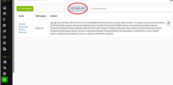

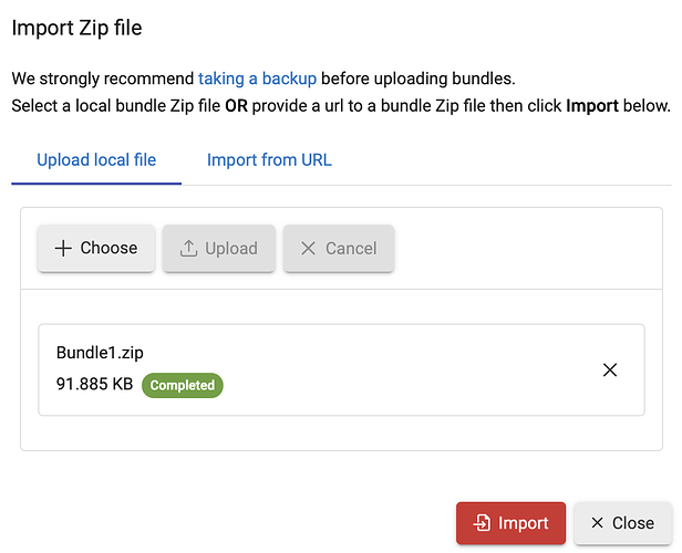

Yeah, I can't get it to work either. I have downloaded the Bundle1.zip file. I click on Import Zip. It shows this:
I click on the red Import button, the screen goes away and nothing is imported.
So, this isn't available in HPM I guess? Is there a trick to getting import bundle to work? Sorry, but this makes me feel really dumb.

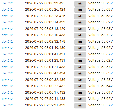

for over a year and half now. Works good enough but my hub is getting hit hard with to many sent events. Sometimes sending multiple within a few seconds. I suppose it sends every instance of voltage change. Is there a way to back off the sent events? Every 2min would be a good event level for me. This also messes up the Plots on home page because the X-axis is so dense with data it only spans like half a day.
Also is there now a Native Hubitat Shelly driver for voltage?
Using either the web page or mobile app, go to Peripheral Settings. On the Voltage Threshold settings adjust the threshold up. Try different amounts depending on how much detail you want.
