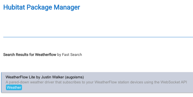

Once HPM is installed use Install and then search by Keyword to find the Weatherflow code you're looking for.
Screenshot 2022-12-30 at 5.38.06 PM
