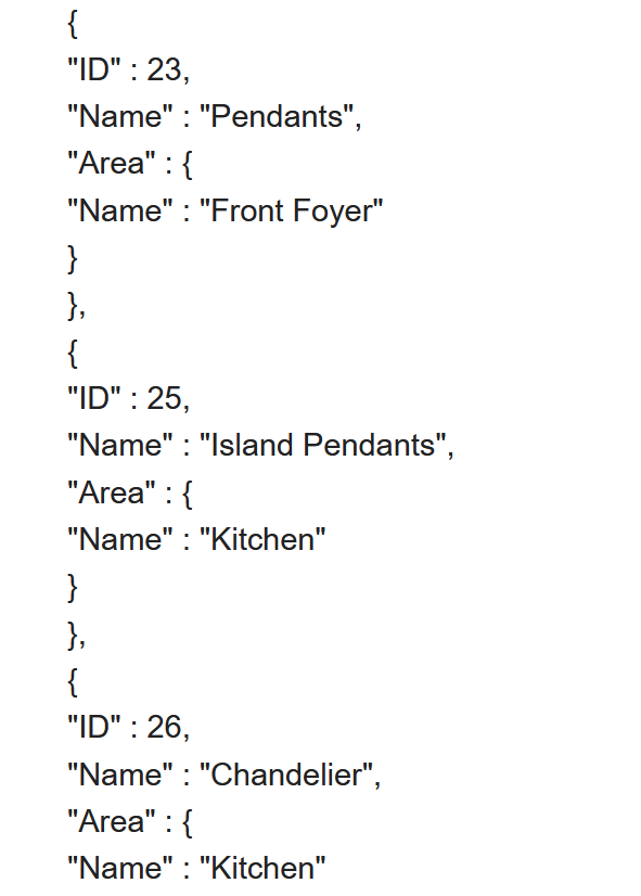

Send a new integration report by email to yourself using the Lutron app.
Using the device ID from the email for your new device, add it manually to the Hubitat Lutron integrator app. There are examples provided for each device type. Click done. The new device will be created automatically.

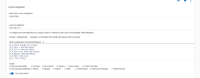

Well we're here to help. Your switches will come right into hubitat and you really won't have to touch the lutron app. It will also be 100% local. I recommend a PC to do your admin stuff on Hubitat as it's easier to get around and you have more display room and what not... Here is an example of some of my switches and dimmers within hubitat
I did the email thing. I had never seen an "Integration Report" before this. The report had only one number called "ID" (I guess since I only had one Lutron device). I entered it in the space marked "Lutron Integration ID."

Mine looks like this?
The name looks odd... it should be a Pico switch...
And, pressing Telenet Support produces no results? The Enable box will not stay checked.
the d stands for dimmer. (all the codes are listed, use the appropriate code for your devices)
During the integration set up click the use configuration list instead of the interactive setup. Then you'll see what I have above and how it's layed out...
Yes, the last entry on my report is the Pico, my one test device. Following the Lutron Instructions, I've made is show up on my Device List.
I see the Config List is to be entered manually. Does each Lutron device require the entire device list, or does each device require only the data related to itself?
I see the Device Type Code does not appear on the Lutron Report. Evidently Lutron does not specify a device type. I also see that you have referred to the "appropriate code." The list of codes has more than one code that might be appropriate for a given device. Can I make that choice myself, based on my intended use? Or is there a way to determine exactly what Lutron needs?

Yan can call the Pico anything you want, but you need to designate it as a Pico in the setup. You'll want to have something like:
2,p,My Pico
