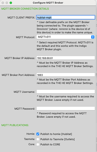

Thank you for the speedy reply. Here is what I setup on my Indigo server:
  1. Installed a plugin called "MQTT Broker"v2022.1.0. Others use Mosquitto as a broker; I thought this would be easier.
  2. Here is the configuration of the plugin.
  3. Note that the IP address 192.168.68.61:1883 points to the Indigo server and not the Hubitat.
  4. Meanwhile, back on the Hubitat, the MQTT broker has the following settings:
    Hub Name
    hubitat-hub
    MQTT Broker Address** prefixed tcp://...*
    tcp://192.168.68.61:1883
    Publish these HE devices to MQTT, ( this is the one lightswitch so far)
    Bunker Lights
Here are some questions..
So, am I "Publishing" this lightswitch "Bunker Lights" to the MQTT plugin, which resides on the Indigo server with IP tcp://192.168.68.61:1883 and not the Hubitat?
Or, is the MQTT Broker app "getting" or pulling the data from the Hubitat with the user code for MQTT app and driver?
What is my next step(s) in getting the Hubitat to communicate with Indigo?
Thank you so much for your help.
